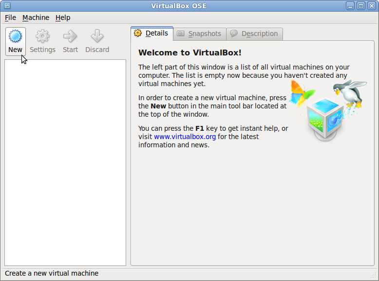

Start the VirtualBox application and click on the New button to create a new VM, and then Next.
../../_images/virtualbox5.png

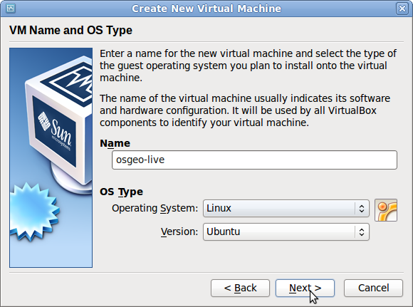

Enter a name such as OSGeo-Live, and choose Linux as the “Operating system”, and Ubuntu as the “Version”.
../../_images/virtualbox_select_name5.png

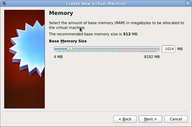

In the next screen set the memory to 1024 MB (or more if your host computer has more than 4GB).
../../_images/vmdk_memory5.jpg

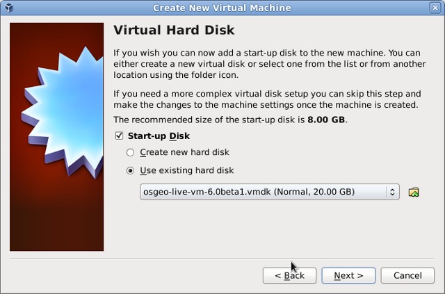

Continue to the next screen and choose “Use existing hard disk” . Now click on the button (a folder icon) to browse to where you saved the osgeo-live-vm-6.0.vmdk file. Select this file, press Next and Create.
../../_images/vmdk_disk5.jpg

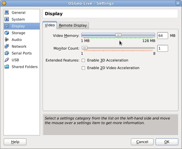

Go to the “Display” section and increase video memory to 32 or 64 MB.
../../_images/vmdk_display5.jpg

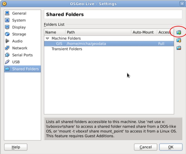

In addition, move to the “Shared Folders” section, and click the “Add folder” (green + icon on the right) to find a directory on your host computer that you wish to share inside the VM.
../../_images/vmdk_shared_folders5.jpg
You can select to make the shared folder read only, and auto-mounted. Once the “Folder path” and “Folder name” are defined, click OK, and again OK to finish and close the settings window.
