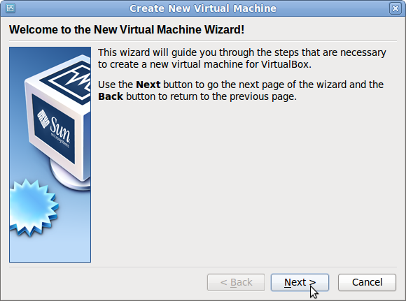

Select New to create a new Virtual Machine.
../../_images/virtualbox_create_vm10.png
Select Next

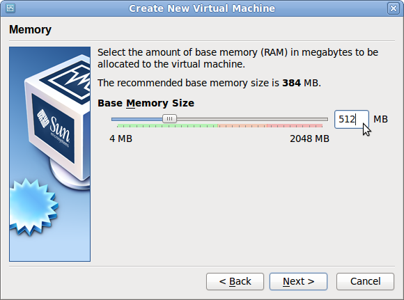

../../_images/virtualbox_memory10.png
Set Base Memory to at least 768 MB, 1 GB is better for trialing java based applications.

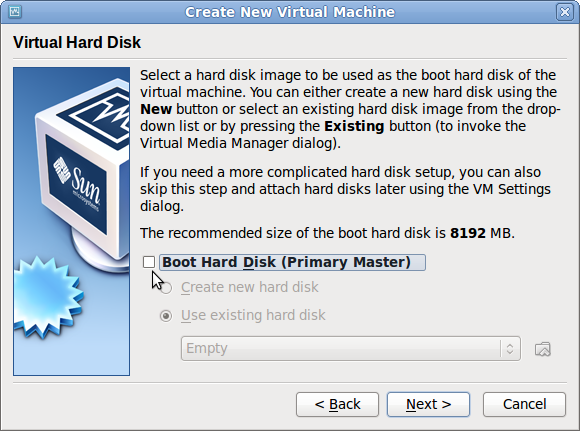

../../_images/virtualbox_no_hard_disk10.png
Simple install: Deselect “Boot Hard Disk”, the Virtual Machine will always boot from an simulated DVD.
If you wish to have a persistent virtual machine, which stores state between sessions and which can have improved screen resolution settings and tools set, then include the hard disk, and install later.

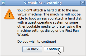

../../_images/virtualbox_warning_no_hard_disk10.png
Select Continue

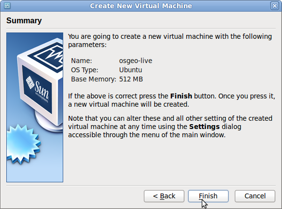

../../_images/virtualbox_final_check10.png
Select Finish

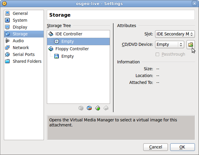

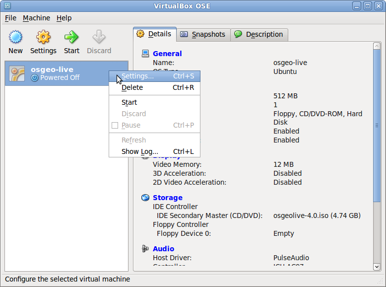

The image is now created, but we now need to simulate having an OSGeo-Live DVD in the CD drive.
Right click on the “osgeo-live” image, and select Settings.
../../_images/virtualbox_set_cd10.png
Select “Storage”, CD/DVD Device, ...

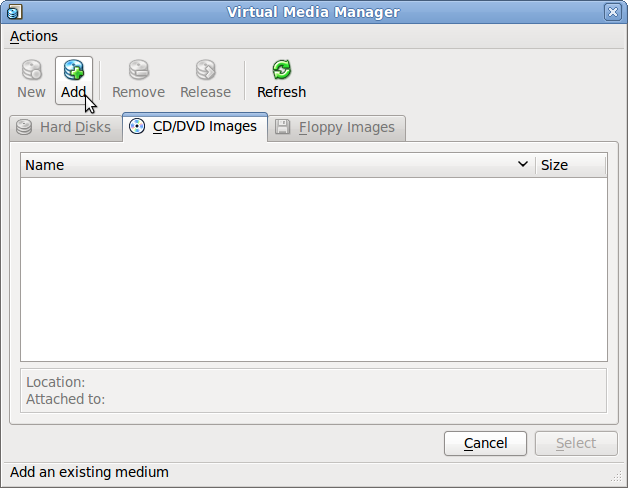

../../_images/virtualbox_add_dvd10.png
Select the OSGeo-Live image.

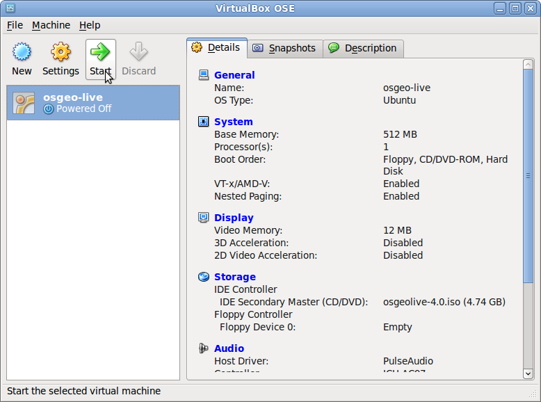

../../_images/virtualbox_start_vm10.png
Now you can start the virtual machine as per the OSGeo-Live Quickstart

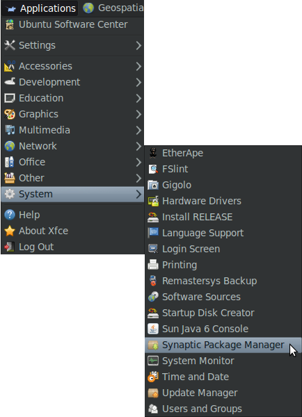

../../_images/virtualbox_synaptic_menu10.png
Select the synaptic package manager application.
Enter password = “user”

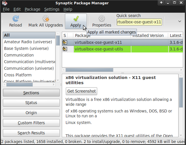

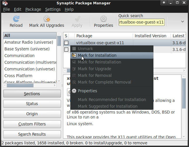

../../_images/virtualbox_synaptic_select_tools10.png
Mark “virtualbox-ose-guest-utils” for installation.
../../_images/virtualbox_synaptic_apply10.png
Apply the changes.
