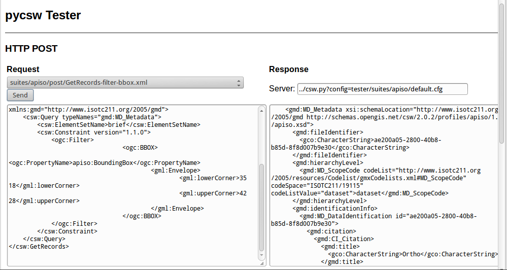

Tester Application

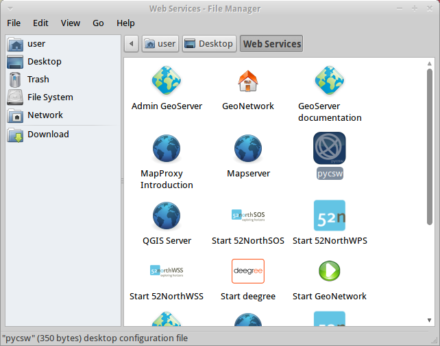

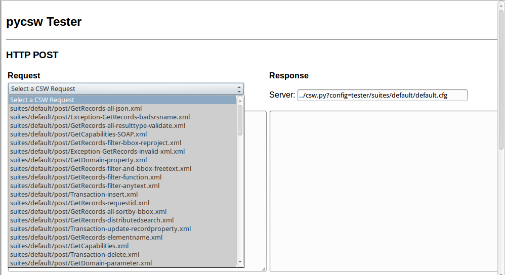

To run the pycsw tester, use the pycsw launcher from the Web Services group, or open Firefox and navigate to http://localhost/pycsw/tester/index.html:
../../_images/pycsw_tester_startup10.png
By selecting the left drop-down list, the user can see various predefined POST requests, encoded as XML, that can be sent to pycsw:
../../_images/pycsw_tester_selection10.png

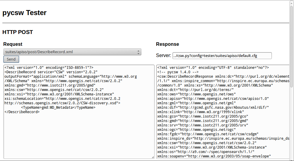

For example, by selecting “apiso/DescribeRecord”, and pushing the “Send” button, a description of the ISO Application Profile record is presented on the right panel:
../../_images/pycsw_tester_describe_apiso_record10.png

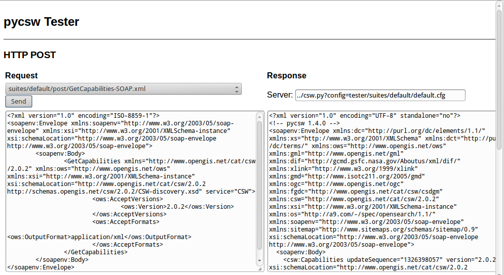

By selecting “GetCapabilities-SOAP” and pushing the “Send” button, a SOAP request is sent to the server to advertise their web service capabilities:
../../_images/pycsw_tester_soap_capabillities10.png
Also, the user can search for data records, performing a spatial bounding box query, by selecting “GetRecords-filter-bbox” and editing the coordinates in the XML request:
../../_images/pycsw_tester_getrecords_bbox_filter10.png
The user can go through all the available requests and perform various requests from this testing application.

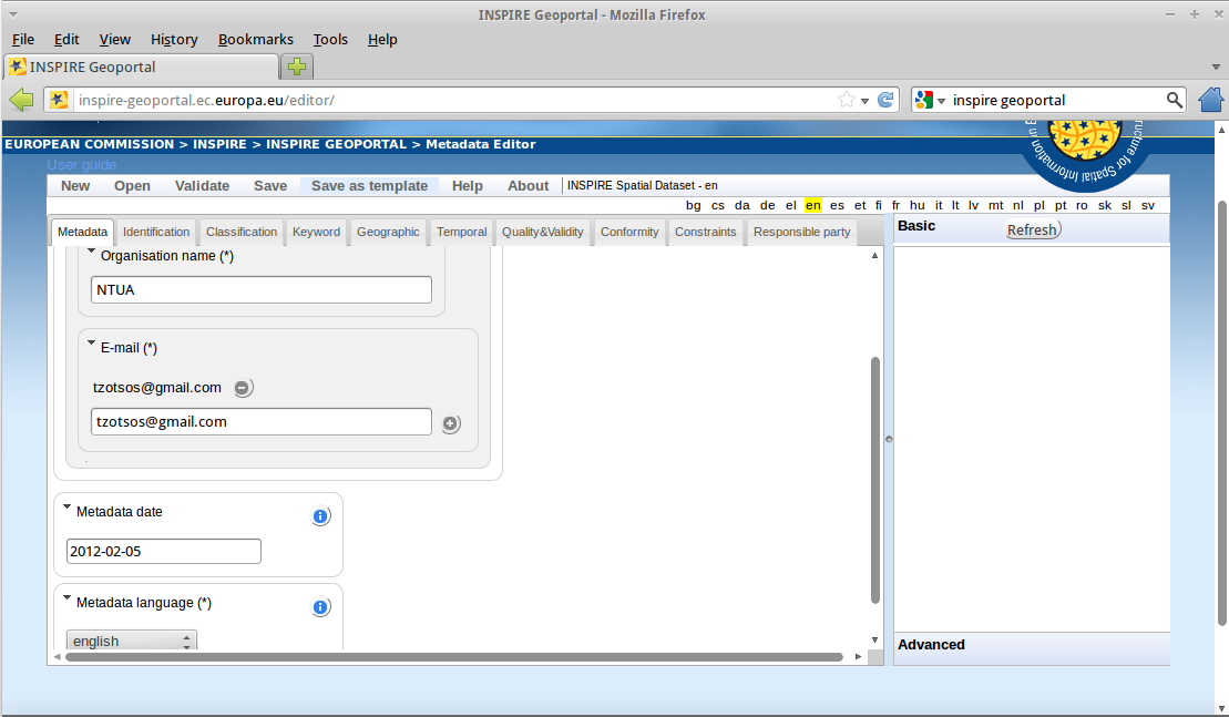

Metadata files for a spatial dataset or a spatial web service can be created through the open source implementation of inspire directive for metadata, European Open Source Metadata Editor (EUOSME). This application can be found at http://inspire-geoportal.ec.europa.eu/editor/. Source code is available at https://joinup.ec.europa.eu/svn/euosme/trunk
The user fills the mandatory metadata fields going through the application tabs, adding information like the name of the data owner, keywords, resource location on the web, geographic location (using a bounding box or the name of a country) etc.
../../_images/pycsw_euosme_metadata_input10.png

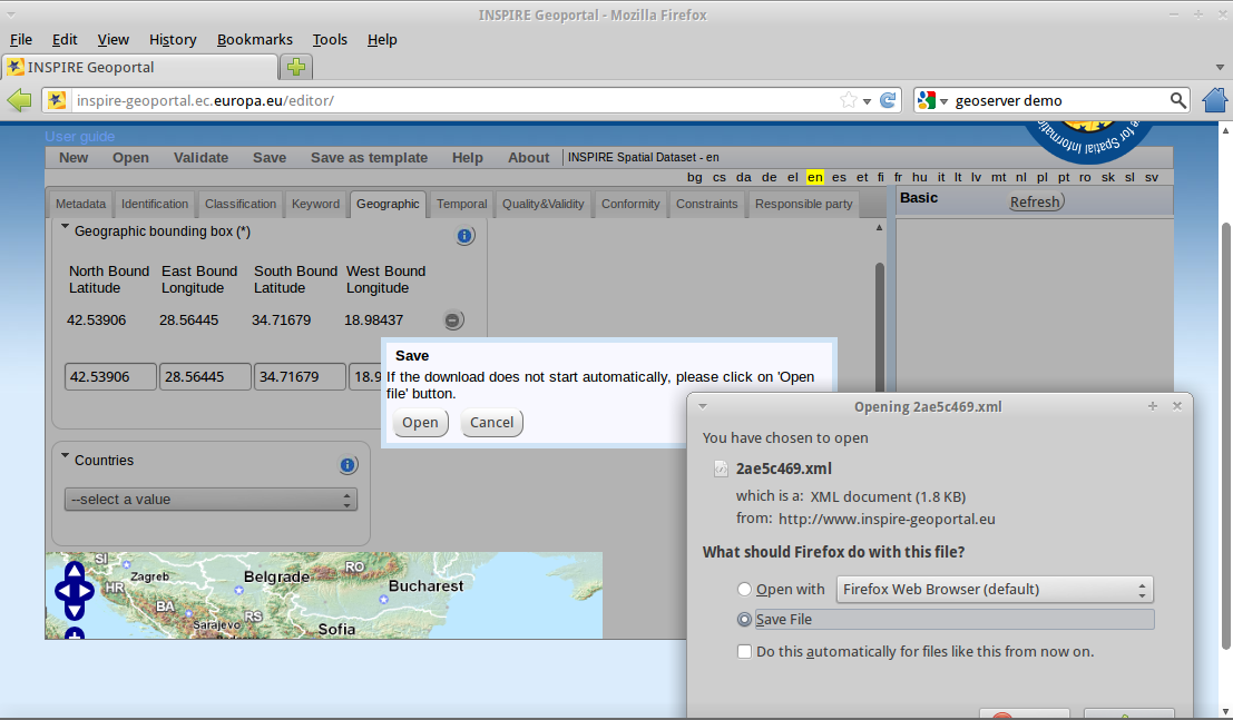

After the user has added all the information available, must push the validation button on top of the page, so that a check to be performed for consistency with the INSPIRE directive.
../../_images/pycsw_euosme_save_metadata10.png
After a sucessful validation, the XML file can be saved to the local disk and viewed through a text editor or a browser.

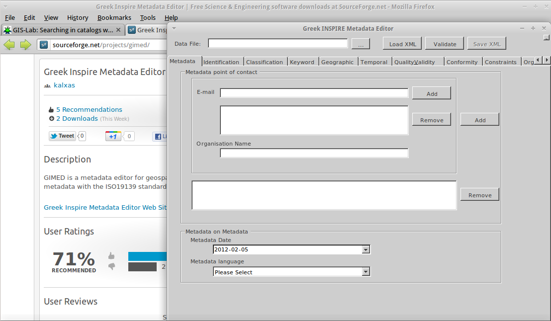

Using GIMED
GIMED is a Free Software for creating and editing INSPIRE compliant metadata XML files. To install the application, use the following commands from a terminal:
$ wget http://downloads.sourceforge.net/project/gimed/GIMED_v1.3.0.tar.gz
$ tar zxvf GIMED_v1.3.0.tar.gz
$ mono ./GIMED_v1.3.0/bin/GIMED.exe
The user can follow the same workflow as in EUOSME to add and edit metadata, without the need for an internet connection.
../../_images/pycsw_gimed10.png

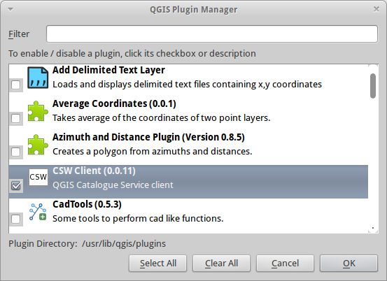

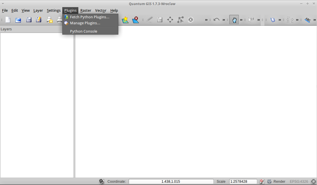

Start QGIS from the Desktop GIS group and go to “Manage Plugins”
../../_images/pycsw_qgis_plugin10.png
Enable the CSW plugin from the list
../../_images/pycsw_qgis_plugin_enable10.png

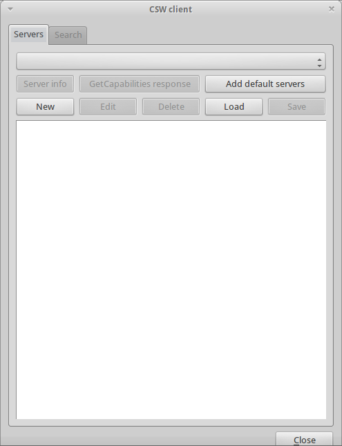

Then select the CSW button from the toolbar and launch CSW Client
../../_images/pycsw_qgis_csw_plugin_open10.png

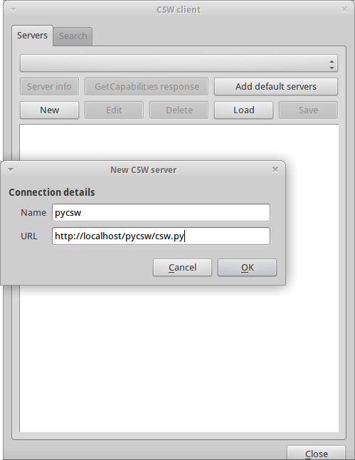

Add the pycsw server by pressing the “New” button and type in http://localhost/pycsw/csw.py

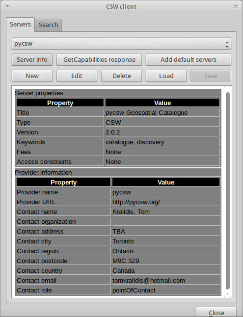

The user can add some default servers using the “Add default servers” button and also get the capabilities of the server using “Server info” button
../../_images/pycsw_qgis_csw_plugin_server_info10.png

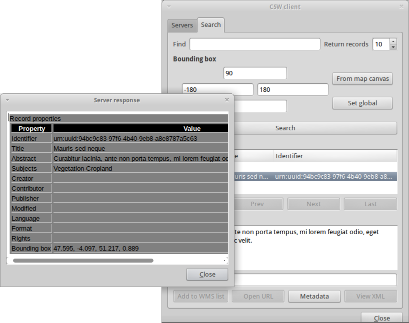

Perform search using the catalogue, either by a string value or with a bounding box
../../_images/pycsw_qgis_csw_plugin_search10.png

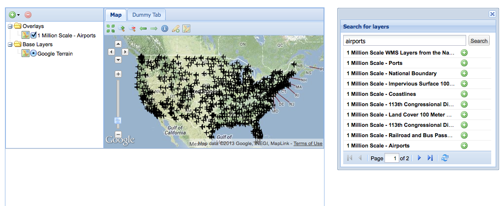

For this tutorial we have hacked a small demonstration in GeoExt (thanks Bart van den Eijnden) using a demo pycsw installation at http://demo.pycsw.org/services/csw:
  • Go to http://demo.pycsw.org/viewer/index2.html
  • Click icon “find layers”
  • Enter “airports” (without double quotes)
  • Click “search” or hit Enter
  • See results
  • Click the “add to map” icon beside the last result on that result set (“1 Million Scale - Airports”)
  • See layer added to map panel

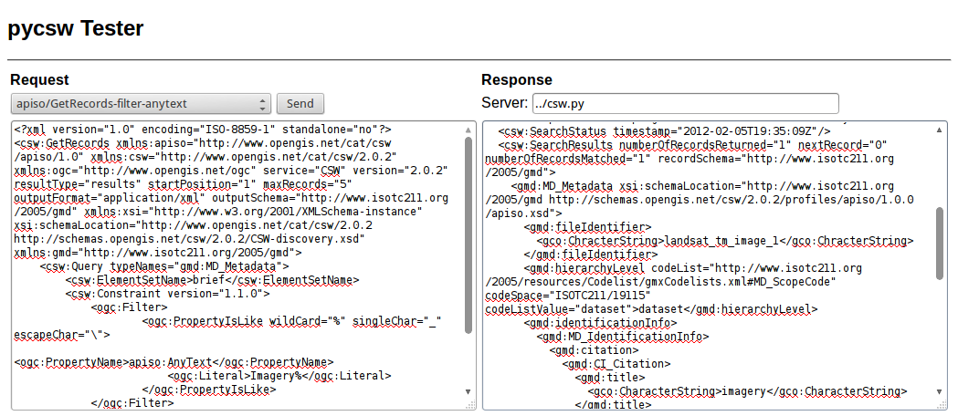

Discovery of data can be also performed through the Tester application by setting the appropriate requests eg. any text search with the string “imagery” leads to discovering the xml data created previously by EUOSME
../../_images/pycsw_tester_discovery10.png
