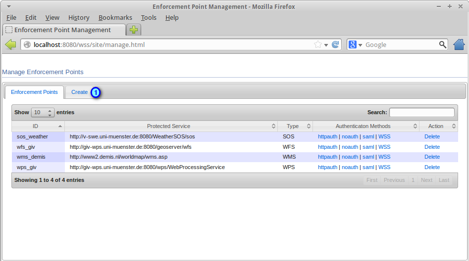

For each protected service, called Enforcement Point, the table contains the base links to the service by authentication method (httpauth, saml, WSS, ...). The table has the following columns:
../../_images/52nWSS_manager_interface5.png
  • Enforcement Point Identifier
  • Protected OGC Service base URL
  • OGC Service Type
  • Available authentication methods
  • Available actions

  2. Press the Create link (1) in the manager main window
    ../../_images/52nWSS_create_enforcement_point5.png
