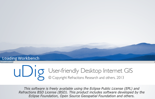

start uDig
  1. Choose Geospatial ‣ Desktop GIS ‣ uDig from menu
  2. The application will take a few moments to start up

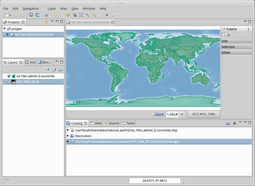

    • A new Map editor will be opened based on the contents of your shapefile. The default name and projection of the Map has been taken from your shapefile.
    • You can see the Catalog view has been updated with an entry for ne_10m_admin_0_countries.shp. This view is used to track the use of resources by the uDig application.
    • The Layers view shows a single layer is displayed on this map. This view is used to change the order and appearance of information in your Map.
    • The Projects view has been updated to show that your map is stored in projects > ne 10m admin 0 countries. You can have multiple projects open at a time, each project can have several maps.
  7. Open up the ~/data/natural_earth2/ folder on the desktop
  8. Drag HYP_50M_SR_W.tif onto the Map Editor, a new layer is added to to the map.
  9. You can see the order the layers are drawn in the layer view. Right now the HYP_50M_SR_W layer is drawn on top of the ne 10m admin 0 countries layer.
  10. Select the HYP_50M_SR_W layer in the catalog view and drag it to the bottom of the list
../../_images/udig_QuickstartCountriesMap9.png

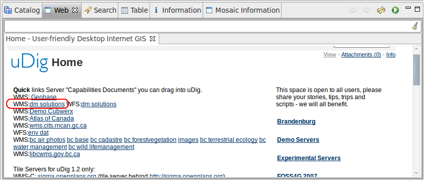

  3. Click on the link WMS:dm solutions link

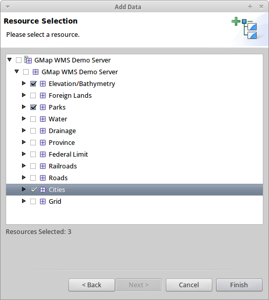

  4. From the Resource Selection page we are going to choose the following layers:
    • Elevation/Bathymetry
    • Parks
    • Cities
      ../../_images/udig_AddWMSLayers9.png

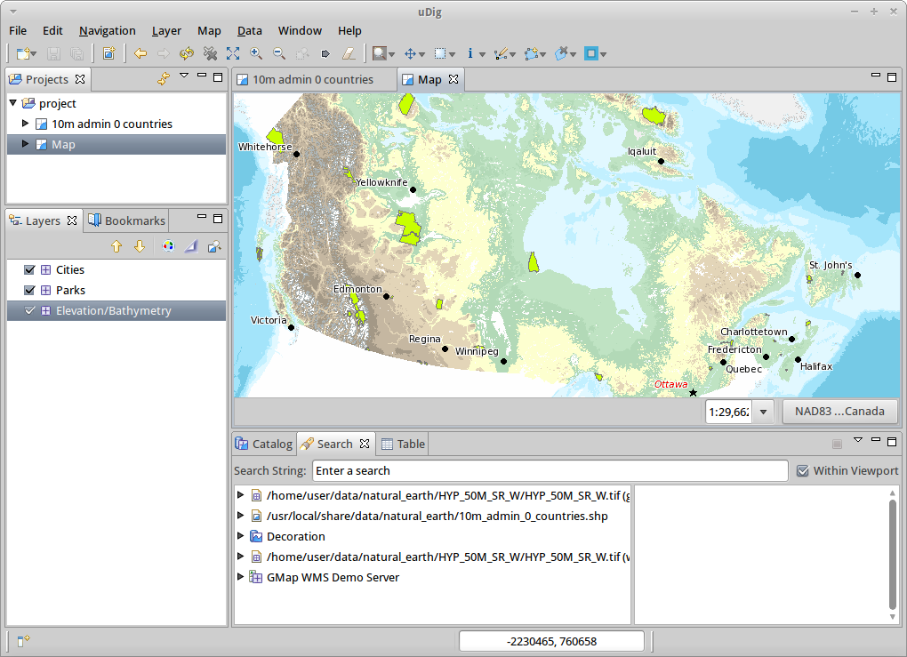

  5. Press Finish to add these layers to your map
    ../../_images/udig_WMSMap9.png
  6. Use the ZOOM Zoom Tool to move closer to one of the Parks
  7. Switch to the INFO Info Tool and click on one the parks to learn more about it
