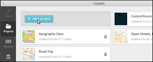

Create a project
  1. Start TileMill and click on the “New project” button on the main screen.
../../_images/tilemill_newproject9.png

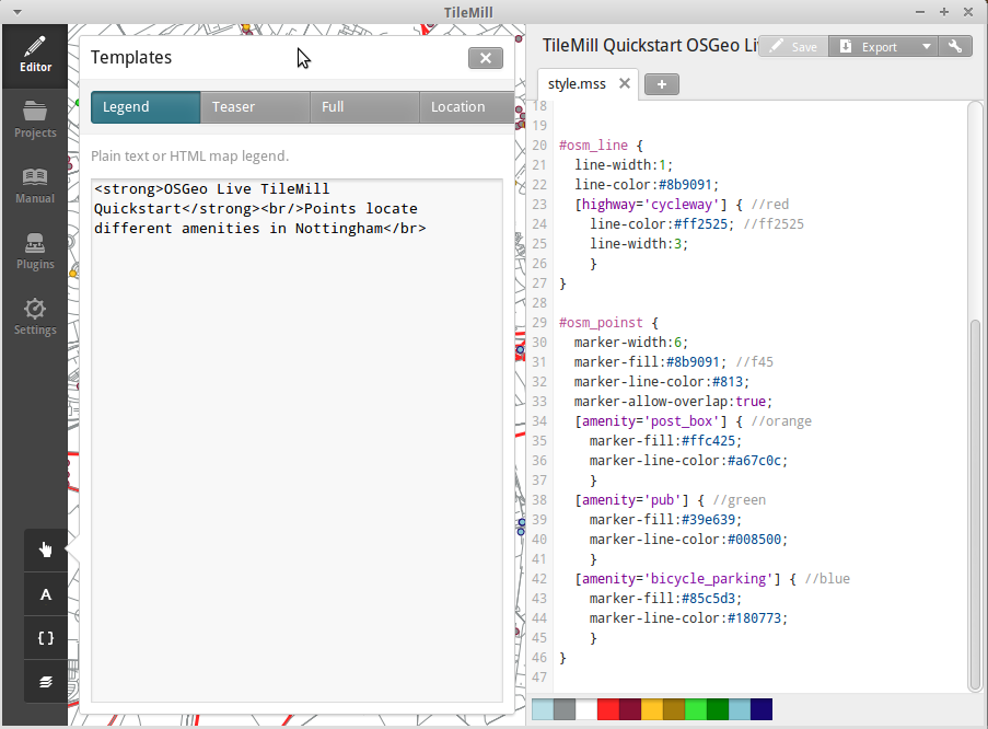

Conditional styles
Conditional CartoCSS styles allow you to change the appearance of the features on your map, based on data attributes. Here we will customize osm_points and osm_roads, in order to highlight some types of feature, given certain values. We will apply different styles to points depending on whether they represent ‘post_box’, ‘pub’or ‘bicyle_parking’, as we know in advance that those are given values in the field ‘amenity’ of the table. We will define a different style to lines that represent ‘cycleway’, as we know in advance that ‘cycleway’ is a given value in the field ‘highway’ of the table. This is our code after changing certain style values and coding some conditional styles:

Legends
A legend is permanently on a map and is useful for displaying titles, descriptions, and keys for what is being mapped. It can be styled using HTML, or it can simply contain an image.
Let’s add a legend that describes the theme of the map.
  1. Open the Templates panel by clicking on the pointer button in the bottom left
  2. The Legend tab is open by default.
  3. Enter your legend text/html in the Legend field:
<strong>OSGeo Live TileMill Quick Start</strong><br/>Points locate different amenities in Nottingham</br>
../../_images/tilemill_legend_text9.png
  1. Click save and close the panel. You will now see your legend in the bottom right corner of the map.
../../_images/tilemill_legend9.png
