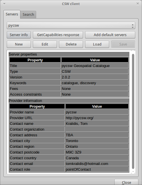

The user can add some default servers using the “Add default servers” button and also get the capabilities of the server using “Server info” button
