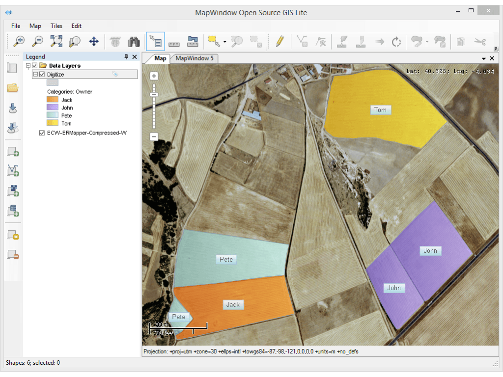

Mapwindow Open Source GIS Lite
This is MapWindow Open Source GIS Lite, a demo of the MapWinGIS ActiveX control version 4.9.5. A similar custom GIS application can be built based on this app or on the barebone MapWinGIS control in a matter of days, using Visual Studio (Pro, Express or Community edition) or SharpDevelop. To showcase all the new features of MapWinGIS v4.9.5 this demo application was created.
MapWindow Lite can do some basic stuff, like opening and closing layers, show tiles, change symbology and labeling. Also new features like the new selection tool, loading data from a PostGIS database and the Shapefile Editor are added. Of course the source code is also available so you can use it to create your own application. Stability has been improved, making this version of MapWinGIS more stable and faster than ever. MapWinGIS v4.9.5 and thus MapWindow Lite use GDAL v2.0.

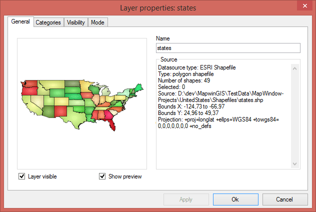

Layer properties
The maps you produce will usually be composed of several GIS data layers. These layers are added either by dragging and dropping files from Windows Explorer onto the map display window or by clicking the Add toolbar buttons. Each layer that is added is listed in the legend window. Double clicking the layer in the legend or right-click on the layer and select Properties will bring up the Layer properties dialog which has several tabs for making changes to a layers properties. For example, to change the name displayed in the legend select the General tab and modify the text in the Name textbox. Other properties will be dealt with in subsequent sections. To remove a map layer right-click the layer and select Remove.
The colored icons displayed in the legend illustrate the type of data in the layers (polygon, line or point) and the current symbology. The order of the layers in the legend determines the overlay order in the map: layers that are higher in the list cover layers that are lower. If a layer seems to be missing it might be because it is completely covered by other layers. To change the order of a layer just click and drag it to where you want it to go. A small checkbox beside each legend entry allow you to turn the display of individual map layers on and off.
MapWindow will display different kinds of GIS data, including: vectors (polygons, lines, and points), rasters (rectangular grids of data) and images. Many different file formats are supported, including .shp, .asc, .aux, .bgd, .bil, .dem, dt1, .hdr, .img, .jpg, .sid, .std, .tif and others. The ESRI shapefile (.shp) is the vector format used by MapWindow when generating new vector files. For grids a GeoTiff proxy image is used. In this Lite version MapWindow can also connect to a PostGIS GeoDatabase.

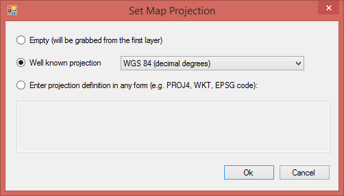

Set map projection
A projection is a mathematical transformation used to display the 3-dimensional earth onto your 2-dimensional computer screen. Different projections are available, each with its own benefits, costs, and appropriate uses. A detailed discussion of projections is beyond the scope of this guide, but a few basic points need to be covered. The main issue is that the various layers in your project all need to use the same projection if the overlays are to line up. In MapWindow, the projection of a layer is defined in a supplemental file carrying the .prj extension. This is a common format for projections, also used in ArcMap and QGis. A layers projection can be viewed in the General tab of the Layer Properties dialog, which is opened by double-clicking the layer in the legend or right-click on the layer and select Properties.
The first map that you add to a project defines the projection for the entire project. Each subsequent layer must have the same projection or MapWindow will display a warning dialog. This dialog allows you to reproject the incoming layer, or do nothing (in which case the layers may be misaligned). Note that reprojecting a layer involves more than just changing the contents of the .prj file, there are also changes to the shape of the polygons. Therefore, it is best to reproject to a new file, rather than overwriting the old.
You can also set the map projection before you add any layers.

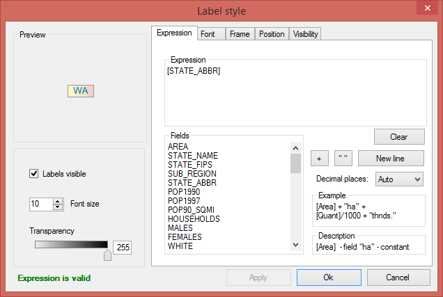

Labels are added or modified by right-click on the layer and select Labels. When you first open this dialog the label preview window will be empty. The first step is to select the attribute that holds the label values. The available attributes are listed in the Fields window. Double-click on the appropriate attribute and it will show up in the Expression window, indicating that it has been selected. Click Apply and a pop-up will ask you how you want to anchor the labels.
Next, open the Font tab and select a font. Note that the default font may not be set, so you might not see anything until you assign the font here. Click Apply and the labels will appear on your map. The Label style dialog has many other options you can use to customize your labels, but none are mandatory. These options are fairly self-explanatory. Click Ok to finish.
