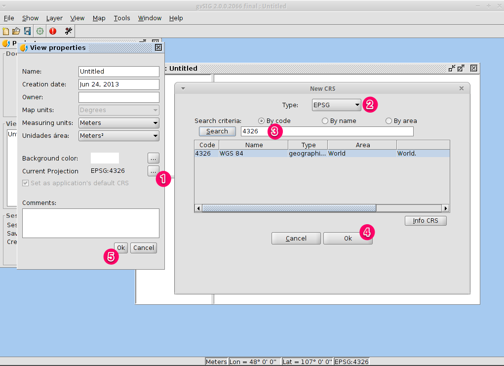

Defining your Coordinate Reference System
  1. Click on the ... button following the Current projection. This will open the New CRS dialog.
  2. Using the dropdown list for Type, select EPSG.
  3. Enter the EPSG code for the Coordinate Reference System. For this example we are using EPSG=4326, which is the WGS84 2D Geographic Projection. Then click on the Search button. This will list the selected CRS in the table below the search input field.
  4. Select OK to return to the View Properties dialog.
Note
The EPSG code is now 4326 and that the map units have changed to degrees.
  1. Select OK to return to the Project Manager.

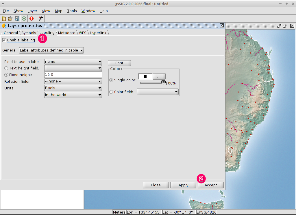

Changing the labelling of a vector layer
  1. Select the Labelling tab at the top of the Layers properties dialog.
  2. Change the text attributes to those shown on the image, then click on the Accept button.
../../_images/gvsig_qs_013_7.png

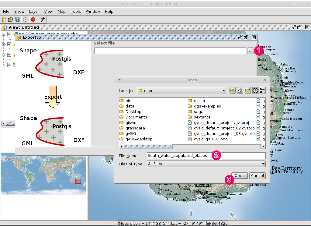

Selecting the output file name
  1. Choose a folder and type the file name.
  2. Click on Open and then on Next.
../../_images/gvsig_qs_024_7.png

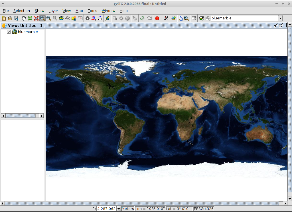

Adding a WMTS layer
WMTS is a evolution of WMS OGC standard based on tile management.
Selecting a server
  1. Within a view, click on the Add layer… button.
  2. Choose the WMTS tab.
  3. Choose the URL shown in the picture.
  4. Click on Connect.
  5. Click on Next.
../../_images/gvsig_qs_039_7.png
Selecting one of the available layers
  1. Select one of the available layers (e.g. bluemarble)
  2. Click on Add.
  3. Click on Next.
../../_images/gvsig_qs_040_7.png
Selecting image format and reference system
  1. Select image/jpeg as image format.
  2. Select EPSG:4326 (notice that the view must have the same SRS. If not then cancel, change it and start again).
  3. Click on Accept.
../../_images/gvsig_qs_041_7.png
The result
A new layer has been added to the view.
