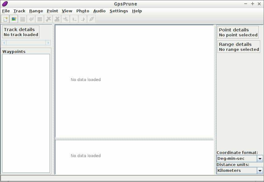

To run GpsPrune on the live DVD, select the icon “GpsPrune” in the Navigation and Maps menu. This will then give you the empty window shown below.

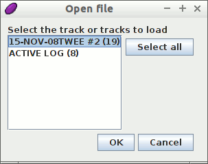

Because this file contains two tracks, we are offered the choice of which one(s) to load. We choose just the first one and press OK.

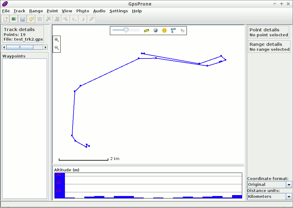

Now you should see the track marked in blue against a white background. If this track had any waypoints (which it doesn’t), then they would be shown too, marked with their names. Below the main map display is an altitude chart, which shows the profile of the track if it contains altitudes.

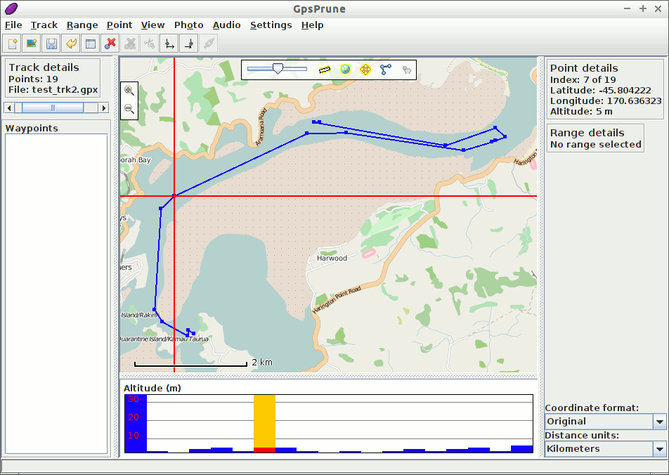

Now, assuming you have a network connection, you can activate the map by clicking the globe icon at the top of the main map display, or with the menu option View ‣ Show Map.
../../_images/gpsprune_mapnik6.png
You can drag the map around with the mouse, and zoom in and out with the mousewheel or by double-clicking. Dragging with the right mouse button defines a rectangle to zoom to, and the right-click menu offers further options. Clicking on a point will show the details including altitude and timestamp if available. You can also click on the altitude profile to select the corresponding point.

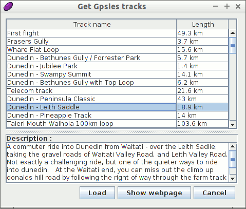

Gpsies
Finally, let’s download another track from the same area. We can use the menu command Track ‣ Get Gpsies tracks to search for tracks on the website gpsies.com. Again, we get a list of matching entries, and we can select one to view the description.
../../_images/gpsprune_gpsieslist6.png
Click the Load button to load the track, and select to append this track to the data we’ve already got. Now we can see both tracks in the same view.
