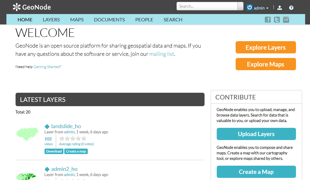

To start GeoNode on your OSGeoLive DVD you have to choose Geospatial ‣ Browser Clients ‣ GeoNode ‣ Start GeoNode and after a few moments the GeoNode webpage will automatically open at http://geonode. The page will look like the image below.

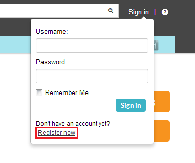

From the interface shown above, one can view and modify existing spatial layers and maps, as well as find information on other GeoNode users. But, without being logged in, you are limited to read-only access of public layers. In order to create a map and add layers to it, you have to sign in first.
From any page in the web interface, you will see a Sign in link. Click that link, and in the dialog that displays, fill in the user credentials. Try “admin” and “admin” for the Username and Password.

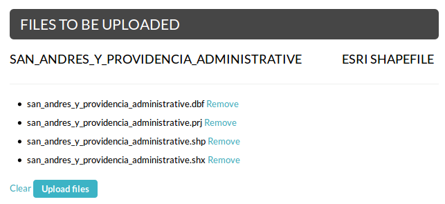

  4. You have two possibilities to add your files. You can either do that by using drag & drop or you choose to browse them. Be aware that you have to upload a complete set of files, consisting of a shp, a prj, a dbf and a shx file. If one of them is missing, GeoNode will warn you before you upload them.
  5. You shold now be able to see all the files you want to upload.
    ../../_images/geonode_files_to_be_uploaded9.png

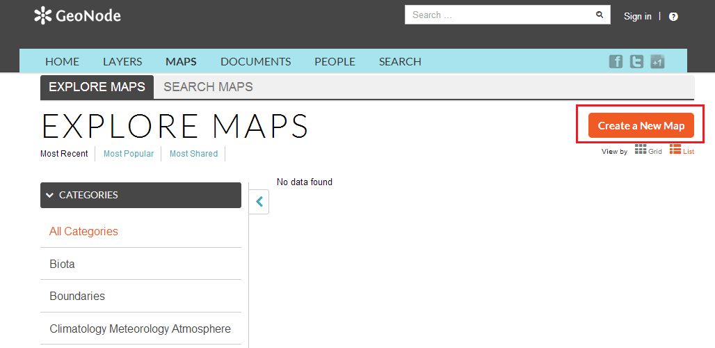

  1. Click the Maps link on the top toolbar. This will bring up the list of maps.
    ../../_images/geonode_maps_quickstart9.png
  2. Currently, there aren’t any maps here. To add one click the Create a New Map button and a map composition interface will display.

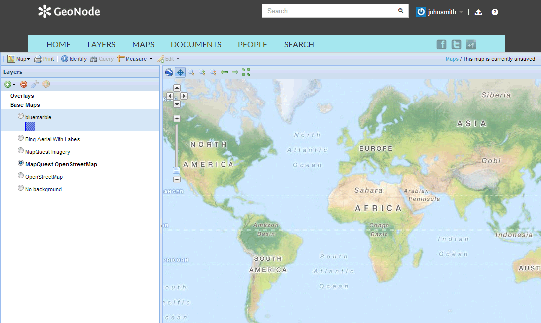

    In this interface there is a toolbar, layer list, and map window. The map window contains the MapQuest OpenStreetMap layer by default. There are other service layers available here as well: Blue Marble, Bing Aerial With Labels, MapQuest, and OpenStreetMap.

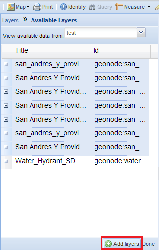

  4. Now you should be able to see all the availabel layers. In your case, this should only be the ones you’ve added before (San Andreas?).
  5. Select all of the layers by clicking the top entry and Shift-clicking the bottom one. Click Add Layers to add them all to the map.
    ../../_images/geonode_addlayersselect_quickstart9.png
  6. The layers will be added to the map. Click Done (right next to Add Layers at the bottom) to return to the main layers list.

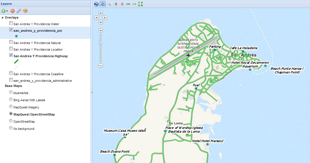

  1. Check the box next to the highway layer to activate it. If it is not below the POI layer in the list, click and drag it down.
    ../../_images/geonode_mapcomposition9.png
  2. Make any final adjustments to the map composition as desired, including zoom and pan settings.

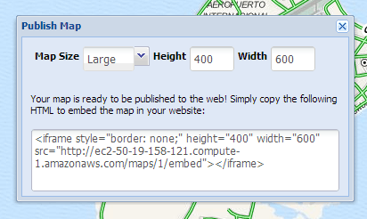

  5. A new dialog will appear with instructions on how to embed this map in a webpage, including a code snippet. You can adjust the parameters as necessary.
    ../../_images/geonode_publishmap9.png
