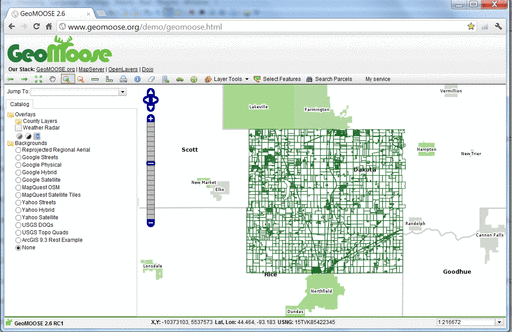

  • Go to the “Browser Clients” folder on the desktop.
  • Click on the desktop icon “Start GeoMoose”. This will launch the default browser which will navigate to the correct location automatically.
  • You will be presented with a web page displaying a demo interface of a GeoMoose instance.
    GeoMoose Screenshot
The Interfaces presented above shows:
  1. A banner bar
  2. A tool bar
  3. A map window with
  • A navigation and zoom controls
  1. A side menu with:
  • A “Jump to” location pull down list
  • Control tabs starting with “Catalog”, for displaying the layer list. As needed, additional tabs will appear: an “Information” readout, a “Custom” output tab, and others.
  1. A Footer bar with:
  • Multiple coordinate readouts, one each for: X,Y (local dataset coordinates), LAT/LON (Decimal) and United States National Grid (USNG)
  • A editable pull down list for a view scales to choose from or define.

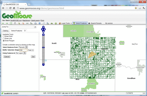

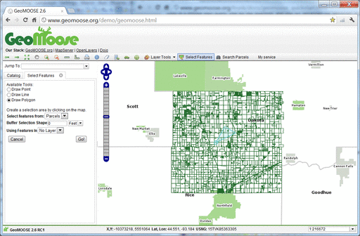

You can select features from a Point, Line, polygon, or a Box. To start, click on the “Select Features” icon (polygon with pencil), and start drawing a selection polygon in the map. You can double click the last point to finish the drawing process. This screenshot shows the drawing process on the map. the left menu is displaying the input form for the criteria of the selection, in this case a Polygon against the “Parcels” layers. You also have the option to select features based on a buffer which is a “0” value by default. This is a service in the GeoMoose Demo package that has been configured to respond to quereies for the “Parcel” layer.
../../_images/geomoose-2_6-screenshot0058.png
The above screenshot is showing the “PARCEL” layer for selects and also using the “Parcels” layer as the attributes to report back on. Two different layers can be used in a double pass query, one for the selection, and one for retrieving the attributes from for reporting. The sceenshot below takes the selection process further by adding in a buffering distance of 100ft.
../../_images/geomoose-2_6-screenshot0068.png

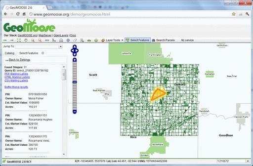

Clicking the “Go!” button in the side menu in the above screenshot will generate a report and display it in the side menu. NOTE: The output can also be configured to be sent to a new window as well.
../../_images/geomoose-2_6-screenshot0078.png
The results above demonstrate the service response to the buffered query by displaying the result in the map via a selection overlay that highlights the original selection area polygon (purple), the crossing and within parcels at a 100ft buffer (orange) and the parcels crossing and within the buffered polygon (yellow). The side menu now displays the reported results of the query process with options for outputting in other formats for mailing labels.

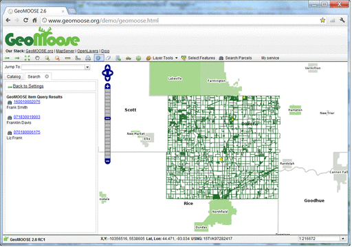

You can also search for features by attribute. To start click on the “Search Parcels” icon and enter your search parameters on the search menu then pressing the “Go!” button. The following screenshot demostrates a search of all parcel owners containing the name “frank”.
../../_images/geomoose-2_6-screenshot011a8.png

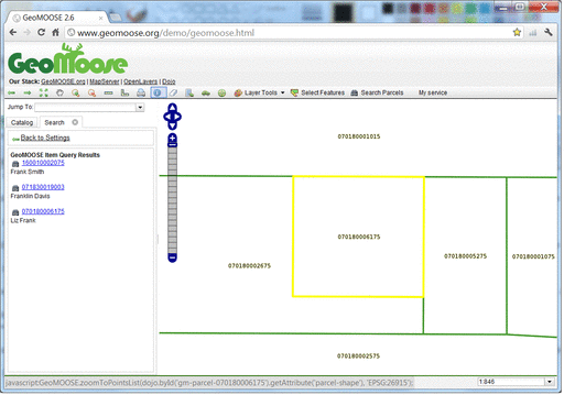

Three results appear in the list and are highlighted on the map.
../../_images/geomoose-2_6-screenshot0118.png
Clicking the binocular icon/parcel number in blue will zoom you to the specific parcel as illustrated in the following screenshot.
../../_images/geomoose-2_6-screenshot0128.png

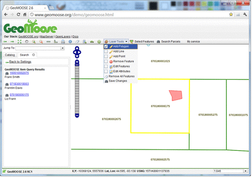

GeoMoose lets you edit layers graphically. Setting up a layer for editing is discussed elsewhere on the GeoMoose website. The demo is setup for you to edit a sketch layer as illustrated in the following screenshot.
../../_images/geomoose-2_6-screenshot0138.png

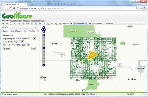

This next screenshot shows what the Print Map service looks as provided with demo for GeoMoose. The side menu in the following view, shows the options available for printing the current mapview. Sheet size, orientation, resolution for both raster image backgrounds and for overall output are also available.
../../_images/geomoose-2_6-screenshot0088.png

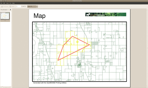

The following screenshot shows an example of a PDF output in landscape mode.
../../_images/geomoose-2_6-screenshot0108.png

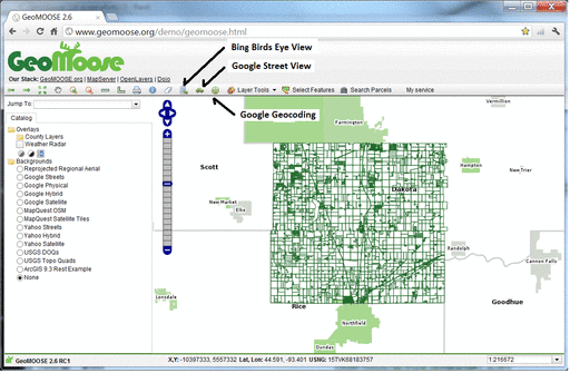

Other Services
GeoMoose can also link to other on-line services such as birds eye view from BING, StreetView from Google and Geocoding from Google. Always remember to review license requirements for any external services to ensure compliance.
../../_images/geomoose-2_6-screenshot0148.png
