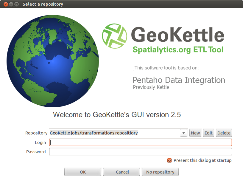

  3. You will be prompted with the following dialog. Fill in the repository information or simply click the “No repository” button to enter the GeoKettle’s workbench

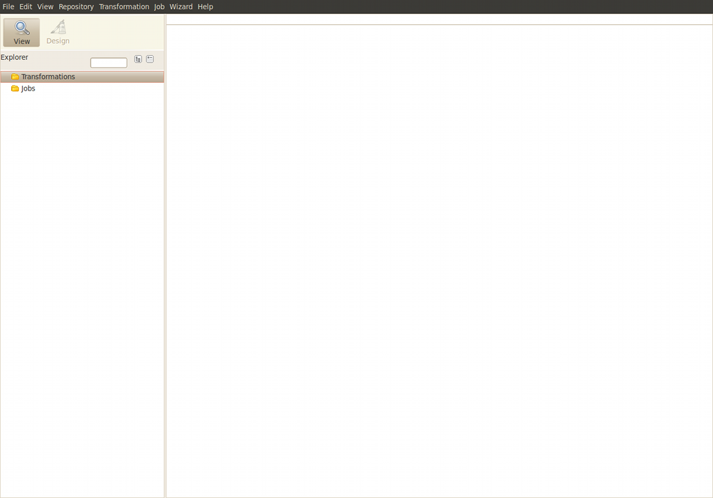

Workbench
As illustrated in the following screenshot, the Workbench window is composed of different panels.
../../_images/geokettle_workbench9.png
The left part acts as a catalog containing all the steps which could compose a data transformation. The right part of the workbench is the area where the transformation itself would be designed and run/debugged.
The contents of these panels will be described further as we demonstrate their use.

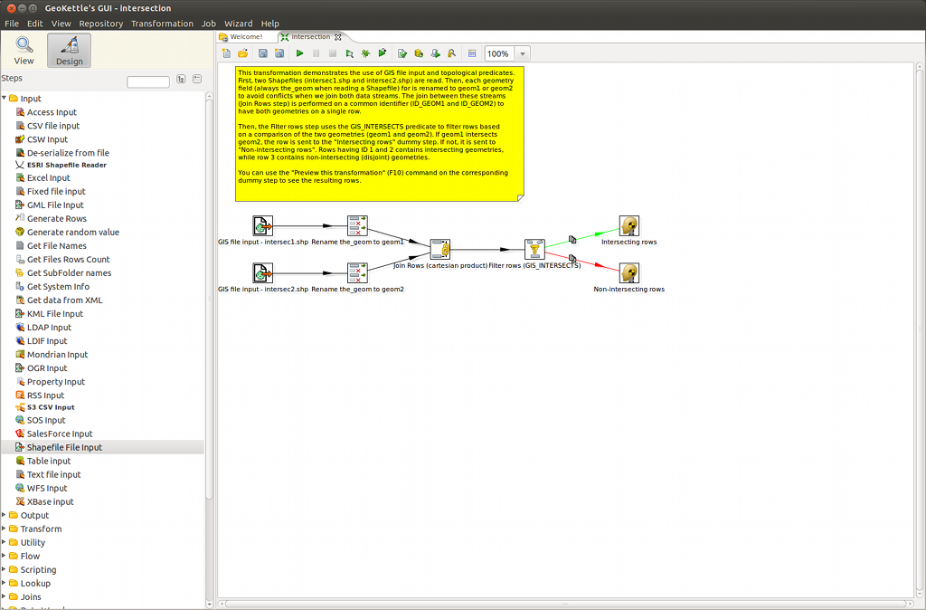

The following picture shows the sample « intersection » transformation.
../../_images/geokettle_intersection_transformation9.png
A description of the transformation and optional directives can be seen in the yellow tooltip area.

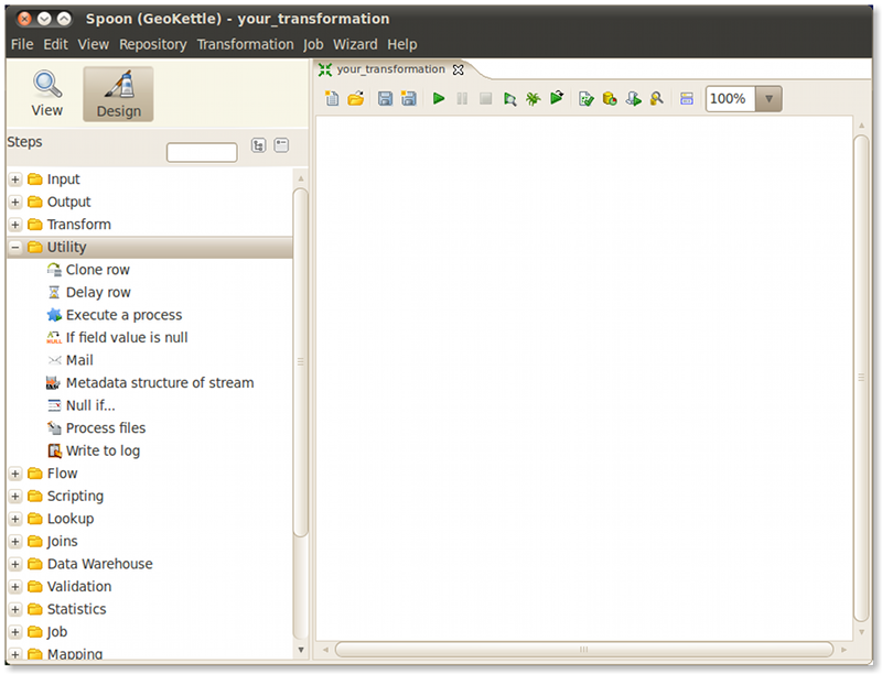

As shown in the following picture, all available steps are listed by category in the left area of the workbench. Expand any category to see its available steps.
../../_images/geokettle_your_transformation9.png
To add a new step to the transformation, drag it from the Steps panel to the transformation panel. You may then customize this new added step to your transformation by double clicking on it.

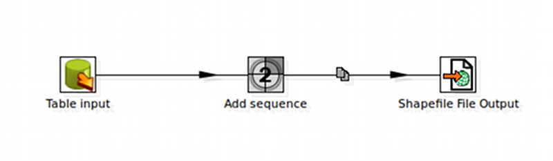

A hop, represented as an arrow between 2 steps, defines the dataflow between those steps. As shown in the following picture, adding a hop from Table Input to Add sequence means that the resulting output of Table Input will be sent to the Add sequence step for further processing and etc.
../../_images/geokettle_hop9.png
To create a new hop, select 2 steps, right click on one of them and select New hop. Another way of doing it is to press and hold Ctrl while selecting the 2 steps.
Any hop can be edited at any time by double clicking on it or right clicking on it and selecting Edit hop in the popup menu.

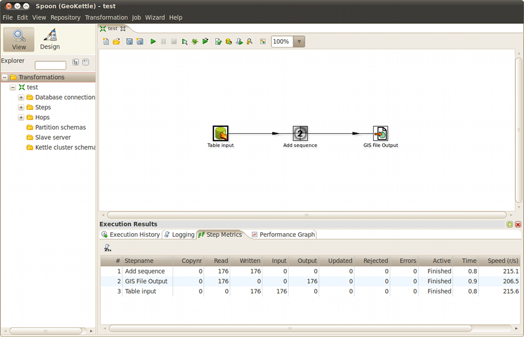

When executing a transformation, a new panel appears below the one where the transformation is designed. This panel (aka the Execution Results panel) contains information about data flow through all steps involved in the transformation.
The Step Metrics tab (shown in the next figure) will be initially displayed. You can see in this tab general information regarding the transformation’s dataflow such as the number of rows read, written, in input and in output in each step. The column Active informs the user if the step is started, running, finished, aborted, etc. The time elapsed since the step has been started is shown in the column Time, as well as the average speed (column Speed) of the step (rows/seconds).

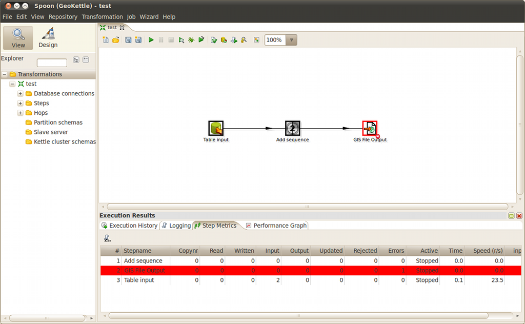

Trying to execute a transformation may result in errors in the Execution Results panel (see next figure). Please then review the content of the Logging tab. There is always a lot of useful information dealing with the source and reason of the error. Modify the parameters of the faulty step and restart the transformation.
../../_images/geokettle_transformation_fail9.png
To help in finding the source of an error, you can also preview the results of a transformation from another step earlier in the workflow. To do so, right click on the step, and select Preview in the popup menu that appears. This way, you can see in a tabular and cartographic way what the data looks like at this point in the overall process without executing the whole transformation.
