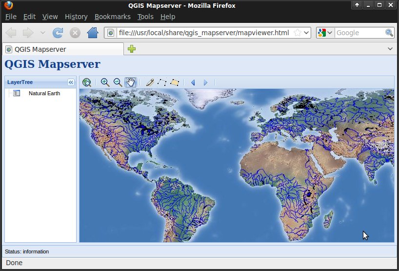

Start GeoExt viewer
OSGeo-Live contains an example of web map viewer based on the GeoExt Javascript framework and using QGIS Server for rendering the map.
  • Click Geospatial ‣ Web Services ‣ QGIS Server
You should see a browser window with a web map viewer showing a world map.
../../_images/qgis_mapserver_browser7.jpg
Alternatively, you can access the application using a browser through http://localhost/qgis_server
