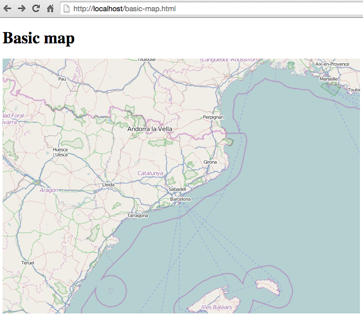

Now try opening basic-map.html from a web browser. You should see the following:
../../_images/openlayers-basic-map4.png

  • The code follows the best practice of loading JavaScipt code at the end of the html file.
  • An OpenLayers map needs to be attached to a HTML DOM element, so we have created a <div> element identified by the map tag.
  • Maps are represented by the ol.Map class. We specify the DOM element to render the map into using the target property.
  • OpenLayers allows map rendering using three different mechanisms: Canvas, WebGL and DOM. Here we select canvas using the renderer property.
  • A map shows data contained within layers, so we have created a tiled layer, represented by the ol.layer.Tile class, that loads content from the OpenStreetMap project, using the ol.source.OSM source class.
  • Finally, we set the initial position of the camera using the ol.View class, set the initial zoom level and center location.

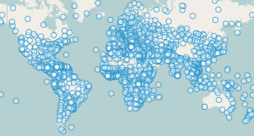

Adding vector layers
Vector layers are represented by the ol.layer.Vector and must use a source suitable for reading the vector format, like ol.source.GeoJSON, ol.source.KML or ol.source.TopoJSON.
var vectorLayer = new ol.layer.Vector({
  source: new ol.source.GeoJSON({
    url: 'url_to_geojson_file'
// Add Vector layer to map
map.addLayer(vectorLayer);
Ex. 5: Constructing a GeoJSON vector layer
../../_images/openlayers-vector4.png
Note, in the previous code we must change the url_to_file to point to a valid GeoJSON file placed in our server. Note that Javascript security will prevents sourcing of datasets from an external URL on a different domain.

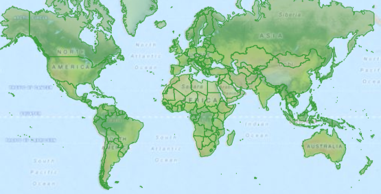

An style is represented by the ol.style.Style class which has properties to set the fill, stroke, text and image to be applied. The next example shows the World’s administrative limits styled to use a green fill and stroke:
../../_images/openlayers-styling4.png

In the code, we have loaded a TopoJSON file and styled it through the style property. We have set a fill and stroke, required for lines and polygons, and an image (in this case a circle) used for point features.
