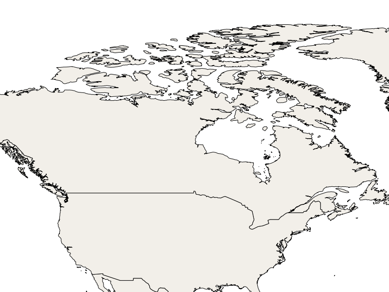

Open a web browser and enter the following URL:
http://localhost/cgi-bin/mapserv?map=/home/user/mapserver_quickstart.map&SERVICE=WMS&REQUEST=Getmap&VERSION=1.1.1&LAYERS=Admin%20Countries&SRS=EPSG:4326&BBOX=-137,29,-53,88&FORMAT=PNG&WIDTH=800&HEIGHT=600
What does the above mean? If we put it in simple words, it’s a Web Map Service (WMS) GetMap request that tells MapServer to “use the following MapFile to render the specified layers as a png image based on some user-supplied parameters such as image size, geographical extent, projection, etc.”. All layers specified in the “&LAYERS=...” property having STATUS ON in the MapFile will be rendered in addition to all layers with STATUS DEFAULT. The result looks like the following:
../../_images/mapserver_map7.png

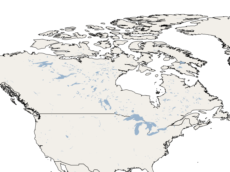

Let’s take our previous WMS GetMap request and add our new “Lakes” layer to the image rendered. We simply need to add the new layer name to the “LAYERS” property list:
http://localhost/cgi-bin/mapserv?map=/home/user/mapserver_quickstart.map&SERVICE=WMS&REQUEST=Getmap&VERSION=1.1.1&LAYERS=Admin%20Countries,Lakes&SRS=EPSG:4326&BBOX=-137,29,-53,88&FORMAT=PNG&WIDTH=800&HEIGHT=600
The image rendered by MapServer looks like our previous map, but with the addition of the lakes from our new layer:

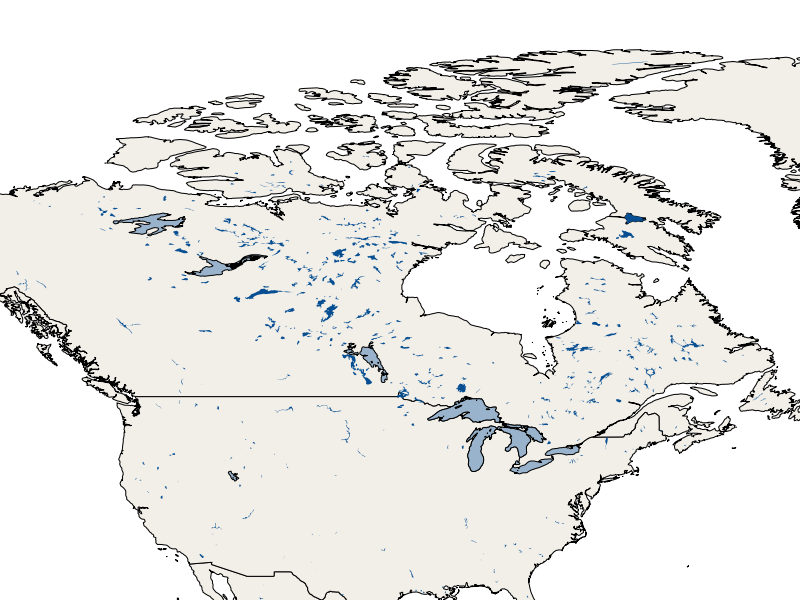

In a MapFile, a LAYER object can contain an infinite number of CLASS objects. These are used to style the elements contained in the spatial data file (DATA). For example, if we look closer at our “ne_10m_lakes” data file using a tool such as ogrinfo, we’ll see the geometry and attribute definitions it contains. These attribute values can be used as a way to draw the elements inside a dataset differently using multiple CLASS objects.
In our “ne_10m_lakes” dataset, we have a ScaleRank attribute, which seems to be related ot the size of the lakes. We can use this as a way to render the lakes differently. In the LAYER object, we’ll add another CLASS object just before our current one:
LAYER
  NAME "Lakes"
  STATUS ON
  TYPE POLYGON
  DATA "ne_10m_lakes"
  CLASSITEM "ScaleRank"
  CLASS
    EXPRESSION /0|1/
    STYLE
      COLOR 153 179 204
      OUTLINECOLOR 0 0 0
    END
  END
  CLASS
    STYLE
      COLOR 153 179 204
    END
  END
END
What does our new CLASS object do? It basically tells MapServer to draw the elements having the “ScaleRank” property equal to “0” or “1” with a black outline. Class objects are always read from the top to the bottom for each feature to be drawn. When a feature matches the “EXPRESSION” specified in a class, that class is going to render the feature. If the feature does not match a class the next class is checked. If a feature does not match any class then it is not rendered at all but if the last class in a layer contains no EXPRESSION then that class acts as a default. The LAYER “CLASSITEM” property tells MapServer which attribute to use when evaluating EXPRESSIONs defined in the CLASS objects.
The result of this new addition should make the big lakes in our map image rendered with a black outline:
../../_images/mapserver_lakes_scalerank7.png
