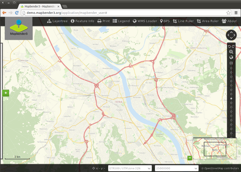

This is how a Mapbender application can look like:
../../_images/mapbender3_basic_application13.png

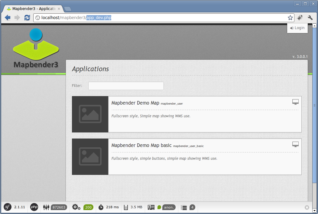

Start Mapbender in the developer mode app_dev.php

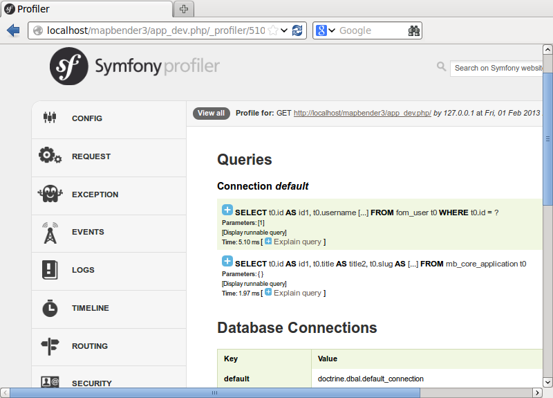

Symfony offers a developer mode with lot of information about your application (logging, exceptions, database queries, memory usage, time and more). This mode is only available from localhost.
../../_images/mapbender3_app_dev5.png
  1. Start the developer mode: http://localhost/mapbender3/app_dev.php
  2. Have a look at the information that is offered in the developer mode.
../../_images/mapbender3_symfony_profiler5.png

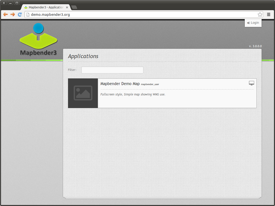

Welcome page
  1. The Welcome page lists applications that are public and can be used by all users. The applications are listed with a screenshot, a title and a description.
  2. You can open an application by click on the title, the screenshot or the start button.
  3. Before you can administrate with Mapbender you have to login to get access to the administration.
  4. Click on Login at right-top to open the login page.
  5. You can login with the user that was generated on installation. It can be root and password root (This is the default user and password that you get after installation of Mapbender on OSGeo-Live. Please change the root password if you want to run a productive environment. Please don’t delete the user root.).
../../_images/mapbender3_welcome5.png
After successful login you are directed to the Mapbender administration.

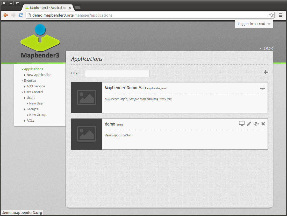

Application overview
After the login you are directed to the Applications with a list of applications you are allowed to access.
The Application overview provides the following functionality:
  • title and description
  • screenshot for the application (if provided)
  • link to the application
  • button to duplicate the application
  • button to edit the application
  • button to publish/unpublish the application
  • button to delete the application
  • button to create a new application
  • with the filter textfield you can search for applications
../../_images/mapbender3_application_overview5.png

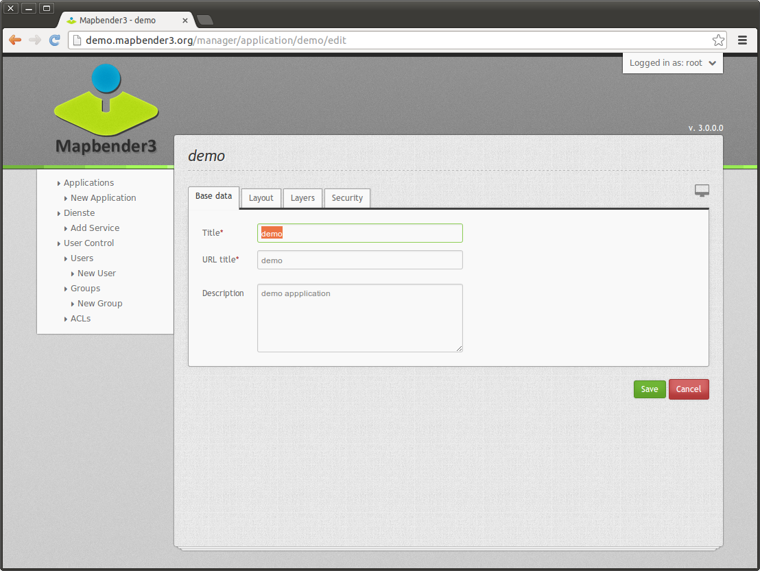

Create an individual application
Create a new application by providing basic information about your application. After that you use the edit mode to add elements, layers and security.
  1. choose Applications ‣ New Application
  2. define a title and description for your application
  3. define an URL title which will be used in the URL to open te application. It can be the same as the title
  4. upload an image file as screenshot for the application overview
  5. choose a template for your application
  6. choose the button Create to create the application
  7. click the Edit-Button at the new application to edit the application
  8. your application is set up. Now you need a WMS to be displayed in your application. This will be described in the section WMS Management.

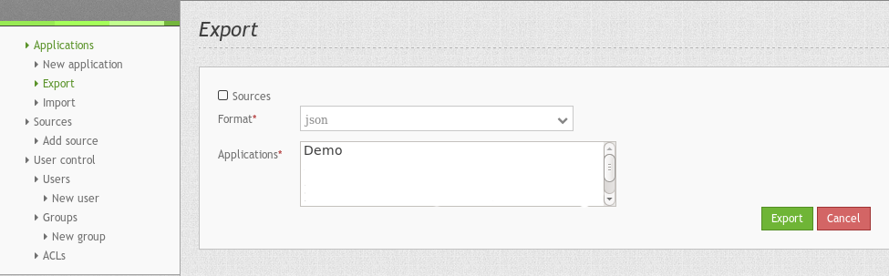

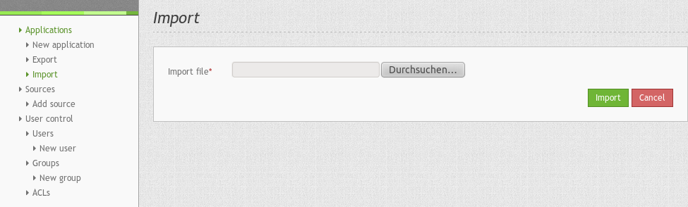

Export / Import applications and sources
You can export applications as JSON or YAML with :menuselection:`Applications –> Export. You can chose one or more applications to export and you can also export the sources which are published in the applications.
../../_images/mapbender3_application_export5.png
The exportfile contains all the definitions of the application/s (sources) and can be imported via Applications ‣ Import in another Mapbender3 installation or in the same installation.
../../_images/mapbender3_application_import5.png

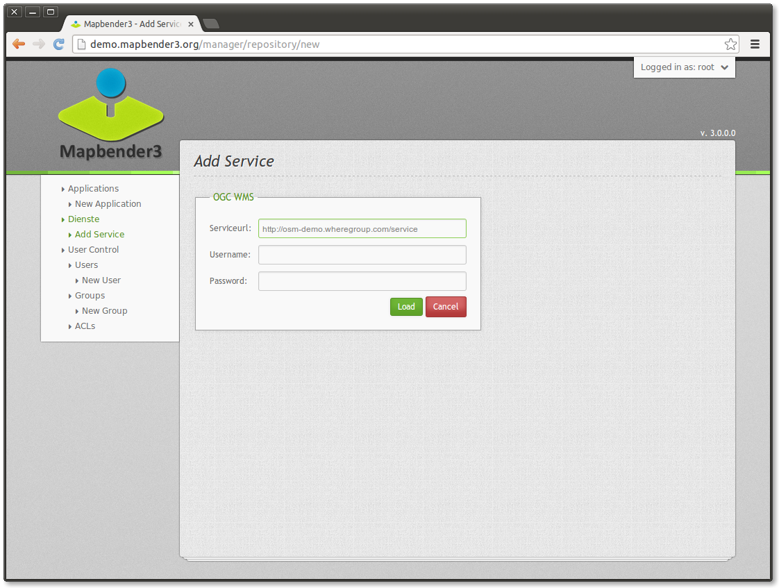

Loading Web Map Services
You can load OGC Web Map Services (WMS) to your application.
A WMS returns an XML-file when the getCapabilities document is requested. This information is parsed by Mapbender and Mapbender gets all the necessary information about the service from this XML
Tip
You should first check the Capabilities document in your browser before you try to load it with Mapbender
  1. Choose menu item Services ‣ Add Service or use the +-Button. Link to the WMS getCapabilities URL in the text field Serviceurl.
  2. Enter username and password if your service needs authentication.
  3. Hit Load to load the Service to the repository.
  4. After successfull registration of the service Mapbender will display an overview on the information that was provided by the service.
../../_images/mapbender3_wms_load5.png

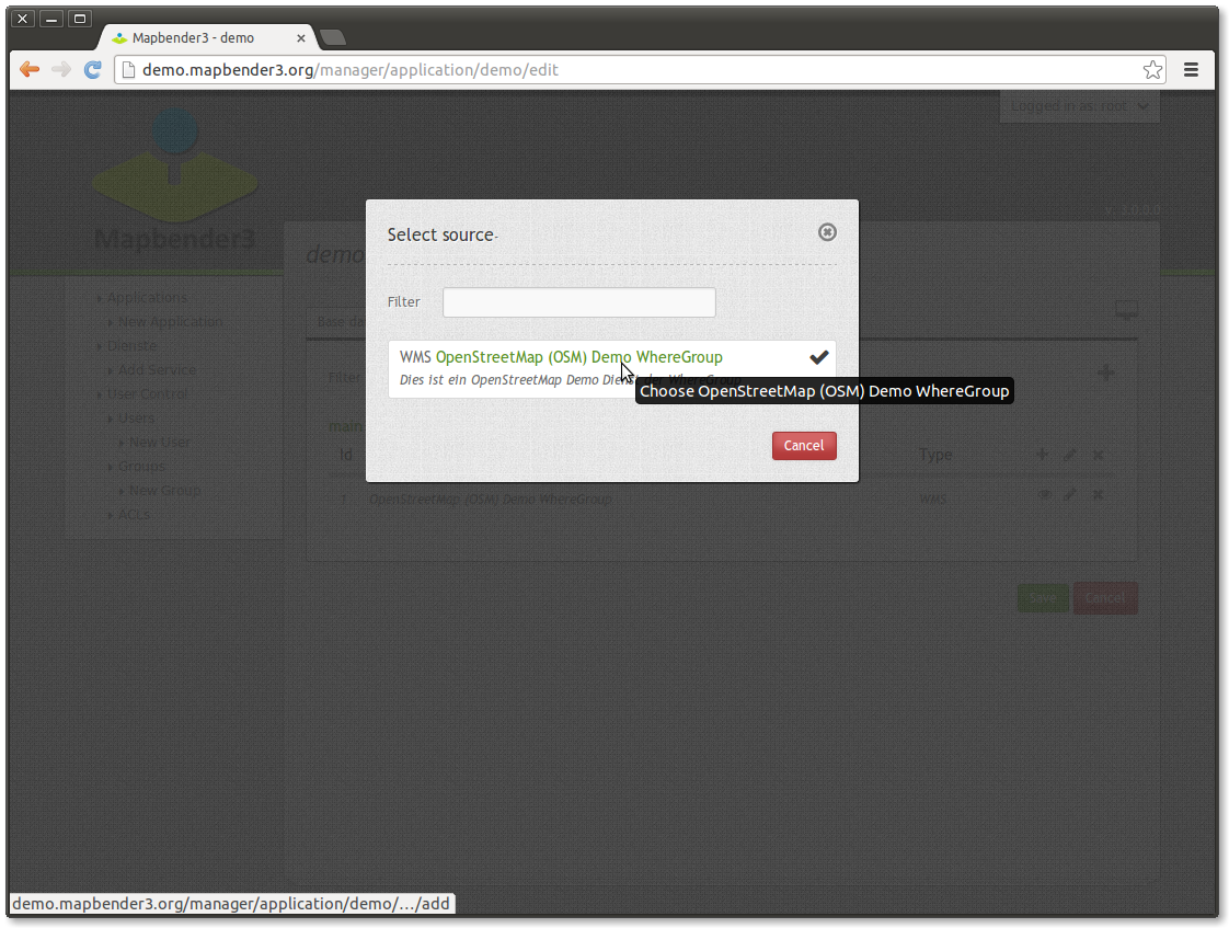

Add Service to Application
After the successfull upload of a WMS you want to add your WMS to an application.
  1. Choose Applications ‣ edit-Button ‣ Layers ‣ Edit-Button.
  2. Click on the +-button to add a layerset, which represents a collection of layers (a possible name could be main)
  3. Now you can add layer to the layerset
  4. Click on the +-button at your new layerset to add a Service.
  5. You can change the order of the Services in your application by drag & drop.

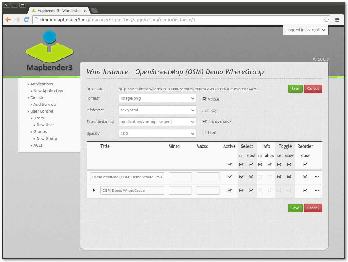

Configure your WMS
You can configure the WMS for your specific application. Maybe you don’t want to provide all layers or you want to change the order or titles of the layer or disable the feature info or change the maxscale for a layer.
  1. Choose Applications ‣ edit-Button ‣ Layers ‣ edit-Button to configure the Service Instance.
  2. You will see a table with the layers of the Service.
  3. You can change the order of the layers via drag & drop
../../_images/mapbender3_wms_application_settings5.png
Service configuration
  • format - choose the format for getMap-Requests
  • infoformat - choose the format for getFeatureInfo-Requests
  • exceptionformat - choose the format for exceptions
  • opacity - choose opacity in percent
  • visible
  • basesource
  • proxy - if active the service will be requested by Mapbender and not directly
  • transparency - Standard ist aktiviert, deaktiviert wird der Dienst ohne transparenten Hintergrund angefordert (getMap-Request mit TRANSPARENT=FALSE)
  • tiled - you can request a WMS in tiles, default is not tiled (may be a good choice if you map is very big an the WMS service does not support the width/height)
  • BBOX factor
  • tile buffer
Layer configuration
  • title - layer title from Service information
  • active (on/off) - enable/disable a layer for this individual application
  • select on - selectable in geodata explorer
  • select allow - layer is active when the application starts
  • info on - layer provides feature info requests, info default activates the feature info functionality
  • info allow
  • minscale / maxscale - the scale range in which the layer should be displayed, 0 means no scale limitation
  • toggle - open folder on start of the application
  • reorder - allows to reorder the layers with drag & drop while using the application
  • ... -> opens a dialog with more information
  • name
  • style - if a WMS provides more than one style you can choose a different style than the default style

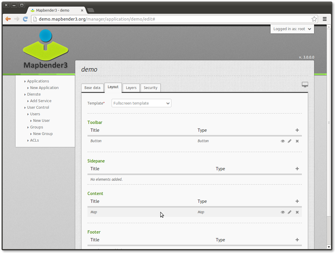

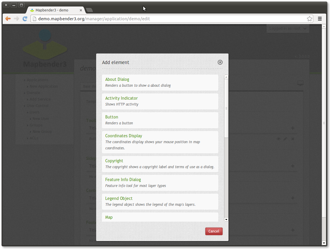

Add Elements to your application
Mapbender offers a set of elements. You can add the elements to your application. You have different regions (Toolbar, Sidepane, Content, Footer) to which you can add elements.
../../_images/mapbender3_application_add_element5.png
  1. Choose Applications ‣ edit-Button ‣ Layers ‣ Button + to get an overview over the elements Mapbender3 provides.
  2. Choose an element from the list.
  3. Notice that you have different areas in your application. Make sure to add the element to a region that makes sense.
  4. Configure the element. Notice: When you select an element for example map you see that the element has a set of attributes. Each element offers individual attributes for configuration.
  5. You can change the position of the element via drag & drop
  6. Have a look at your application. Open your application from Applications ‣ Applications Overview
Now you should get an idea how easy it is to change a Mapbender application without changes in the code.
../../_images/mapbender3_application_elements5.png

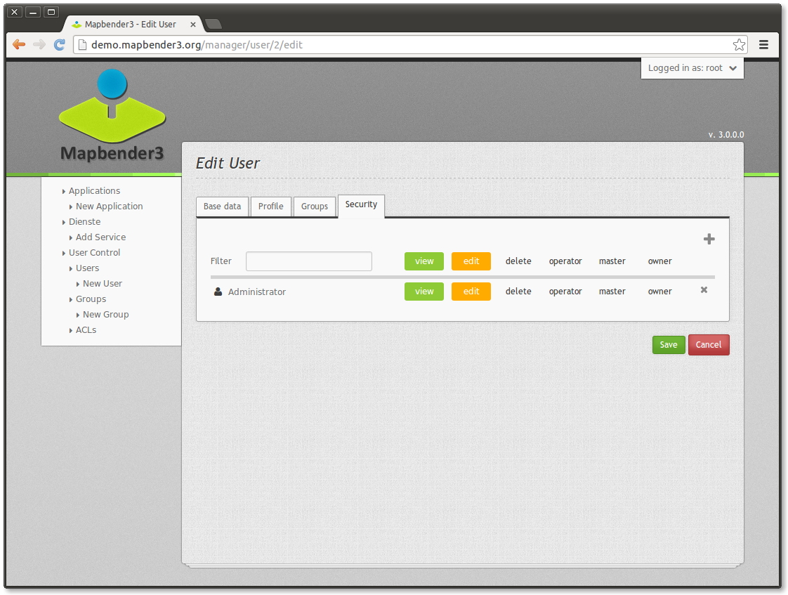

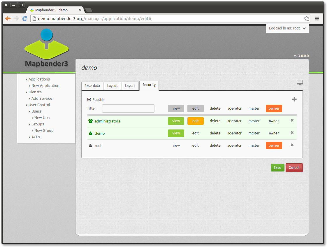

User and group management
An access to Mapbender requires authentication. Only public applications can be used by everyone.
A user has permissions to access one or a set of applications and services.

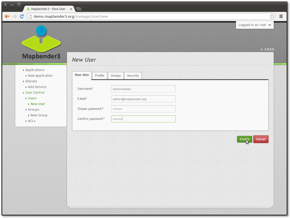

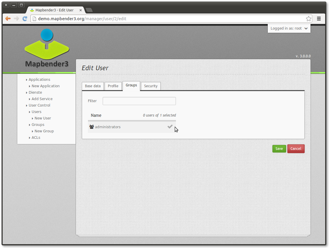

Create a user
  1. To create a user go to New User or click the +-Button.
  2. Choose a name and a password for your user.
  3. Provide an email address for the user.
  4. Save your new user.
  5. You can provide more information about the user in the tab Profile.
../../_images/mapbender3_create_user5.png
Create a group
  1. Create a group by New Group.
  2. Define a name and a description for your group.
  3. Save your new group.
Assign users to group
  1. Assign a user to a group by Users –> Groups.
  2. Choose one or more users you want to add to the group at Users.
  3. Assign a user by Users ‣ Edit-Button‣ Groups to a group.
../../_images/mapbender3_assign_user_to_group5.png
Roles
Mapbender3 provides different rights. They refer to the Symfony ACL System http://symfony.com/doc/2.1/cookbook/security/acl_advanced.html#built-in-permission-map
  • view - Whether someone is allowed to view the object.
  • edit - Whether someone is allowed to make changes to the object.
  • delete - Whether someone is allowed to delete the object.
  • operator - Whether someone is allowed to perform all of the above actions.
  • master - Whether someone is allowed to perform all of the above actions, and in addition is allowed to grant any of the above permissions to others.
  • owner - Whether someone owns the object. An owner can perform any of the above actions and grant master and owner permissions.
  1. Assign roles to a user by Users ‣ Edit your User ‣ Security.
../../_images/mapbender3_roles5.png
Assign an Application to a User/Group
  1. Edit your application by Application ‣ Edit-Button.
  2. Choose Security
  3. Set permission like view edit delete operator master owner
  4. Assign a user/group to the application
  5. Test your configuration!
  6. Logout from Mapbender by Logout.
  7. Login as the new user
../../_images/mapbender3_security5.png
