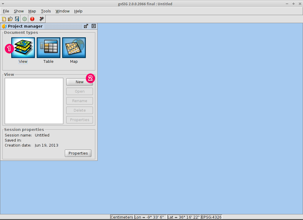

Start gvSIG and create a view
Select gvSIG from the application menu, Geospatial ‣ Desktop GIS ‣ gvSIG. The application usually takes about a minute to startup.
  1. By default gvSIG opens with an empty project file with the ‘View’ document type selected. However, on OSGeo-Live, gvSIG has been configured to start with a default project. Click on the New Project button or go to File ‣ New Project. When prompted, you can select Discard Changes as we won’t be using the last project.
  2. Click on the New button to create a view. It will be opened automatically.
../../_images/gvsig_qs_001_6.png

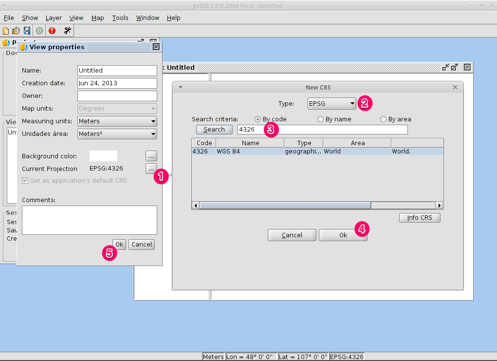

Open the view properties dialog
  1. Select View ‣ Properties.
../../_images/gvsig_qs_002_6.png
Defining your Coordinate Reference System
  1. Click on the ... button following the Current projection. This will open the New CRS dialog.
  2. Using the dropdown list for Type, select EPSG.
  3. Enter the EPSG code for the Coordinate Reference System. For this example we are using EPSG=4326, which is the WGS84 2D Geographic Projection. Then click on the Search button. This will list the selected CRS in the table below the search input field.
  4. Select OK to return to the View Properties dialog.
Note
The EPSG code is now 4326 and that the map units have changed to degrees.
  1. Select OK to return to the Project Manager.
../../_images/gvsig_qs_003_6.png

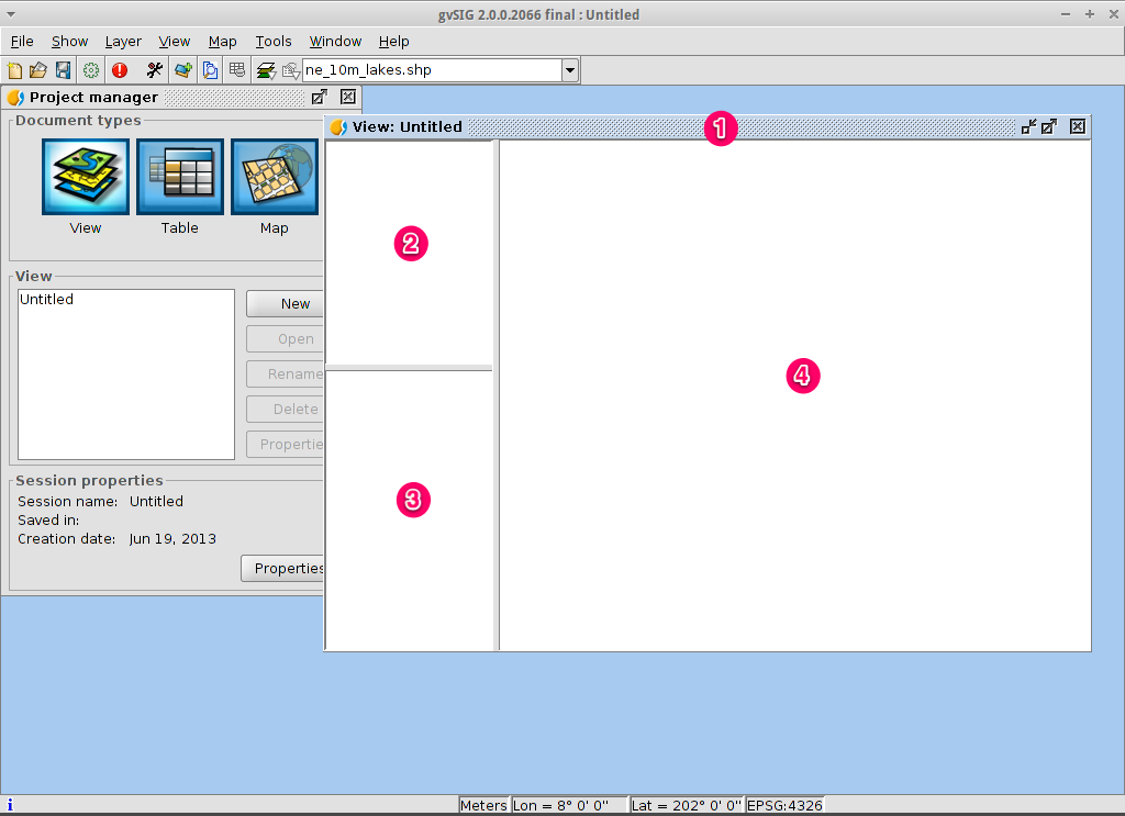

Knowing the parts of a view
  1. The view window consists of three zones.
  2. The top-left cell contains a list of vector or raster layers being used in the view (i.e. Table-of-Contents).
  3. The bottom-left cell displays the extent of the main view over a selected vector file.
  4. The right cell is the main display area where raster and vector data is rendered.
../../_images/gvsig_qs_005_6.png

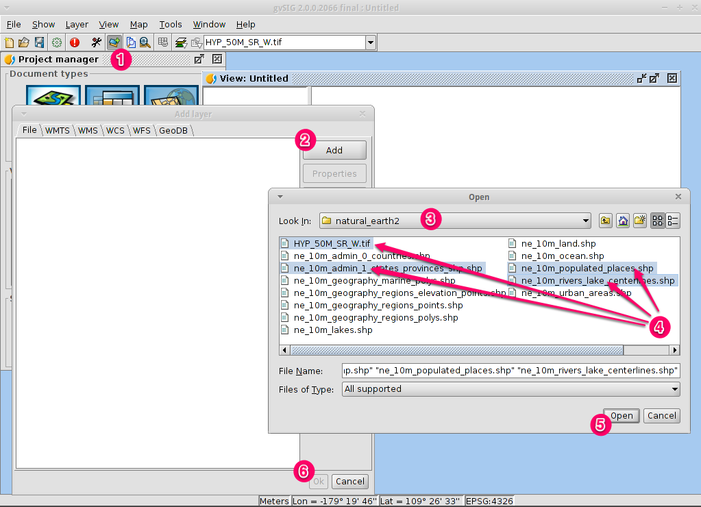

Adding layers from files
  1. Click on the Add layer icon in the main toolbar to open the Add layer dialog.
  2. Select Add in the Add layer dialog. By default the first tab is File so the Open file dialog will appear.
  3. Drill down to the /usr/local/share/data/natural_earth2/ directory.
  4. Select the files as shown in the picture.
../../_images/gvsig_qs_006_6.png
Note
By default all formats are shown so we can select both vector and raster files at a time by keeping pressed the CTRL key.
  1. Click on the OK button to return to the Add layer dialog.
  2. Click on the OK button on the Add layer dialog to return to the view.

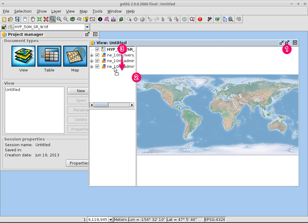

The View - basic navigation
Preparing the view
  1. Click on the Maximize icon for a better viewing of the data.
  2. The size of the Table-of-Contents column can be adjusted using the mouse to help see long file names.
  3. In case the raster layer is on the top it should be moved manually to the bottom.
../../_images/gvsig_qs_008_6.png

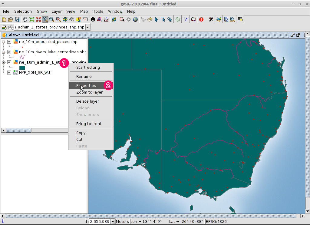

Making a polygon transparent
  1. Select the ne_10m_admin_1_states_provinces.shp layer using the left-mouse-button and click again with the right-mouse-button.
  2. Select the Properties submenu.
  3. The Layer properties dialog box will appear.
../../_images/gvsig_qs_010_6.png

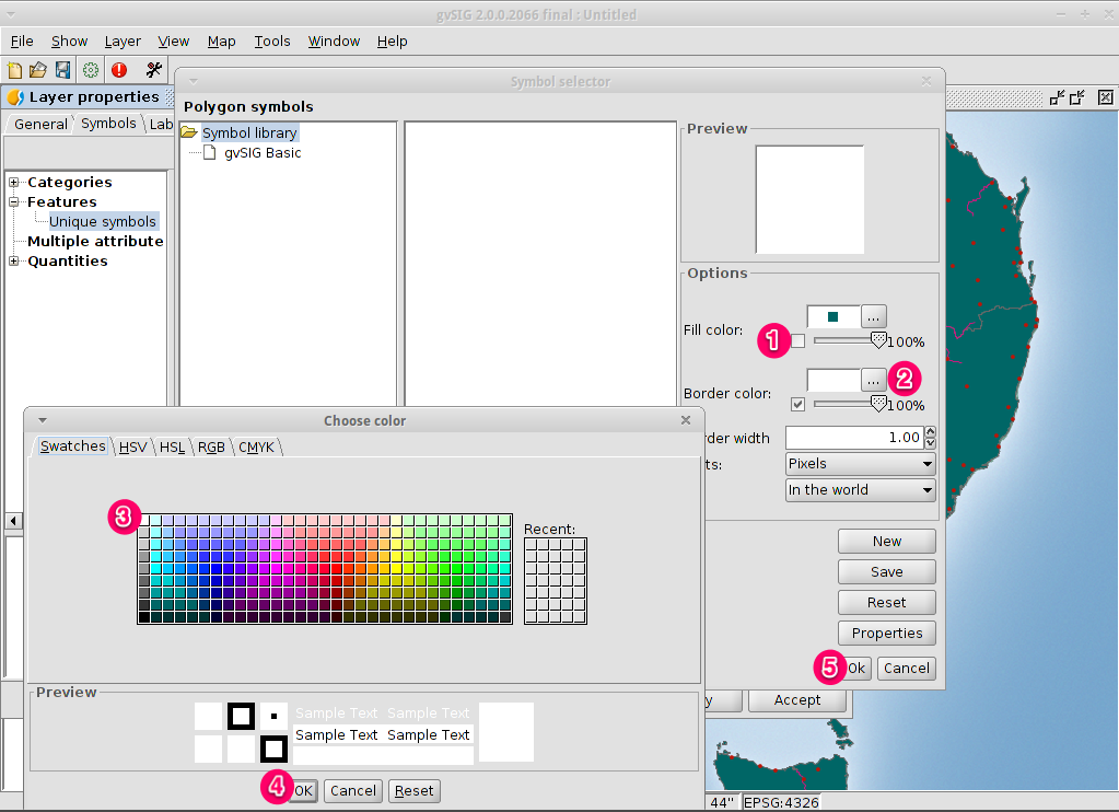

  1. Select the Symbols tab at the top of the Layers properties dialog.
  2. Select Choose symbol button so the Symbol selector dialog appears.
Removing the fill symbol and changing the border color
  1. Uncheck the Fill color box so the polygons are transparent.
  2. Click on the ... close to Border color:.
  3. Choose white as color.
  4. Click on the OK button to return to the Symbol selector dialog.
  5. Click on the OK button to return to the Layers properties dialog.
../../_images/gvsig_qs_012_6.png

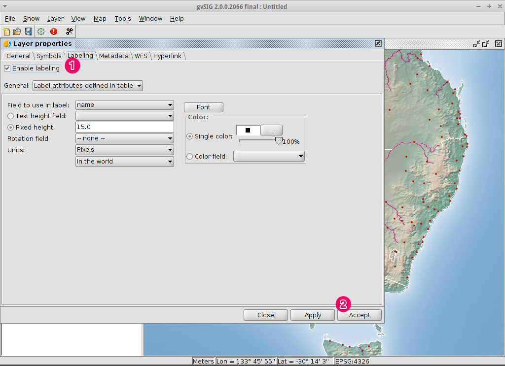

Changing the labelling of a vector layer
  1. Select the Labelling tab at the top of the Layers properties dialog.
  2. Change the text attributes to those shown on the image, then click on the Accept button.
../../_images/gvsig_qs_013_6.png

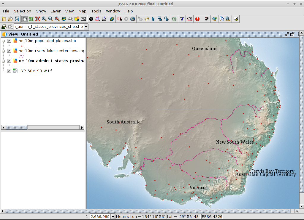

The result
Note that this is a very basic view showing a point, a line and a polygon vector file superimposed over a raster file. It is just as easy to have an aerial photograph or Digital Terrain Model as a backdrop to your vector data, or to show other vector data stored in different formats.

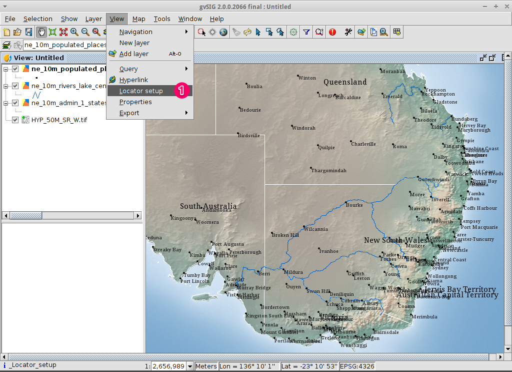

Opening the Locator setup
  1. Select View ‣ Locator setup.

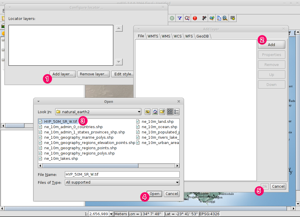

Adding a layer to the overview zone
  1. Click on the Add layer… button.
  2. Within the Add layer window, click on the Add button.
  3. Select the HYP_50M_SR_W.tif layer.
  4. Click on the Open button to return to the Add layer window.
  5. Click on the Ok button and close the Configure locator window.
../../_images/gvsig_qs_017_6.png

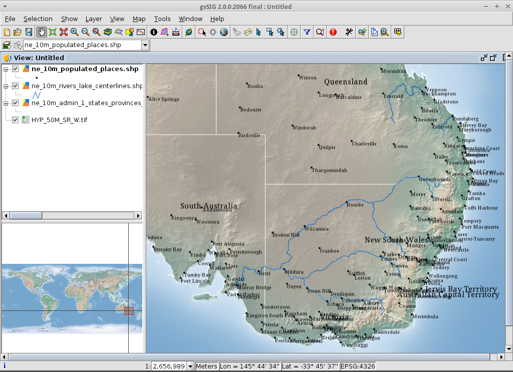

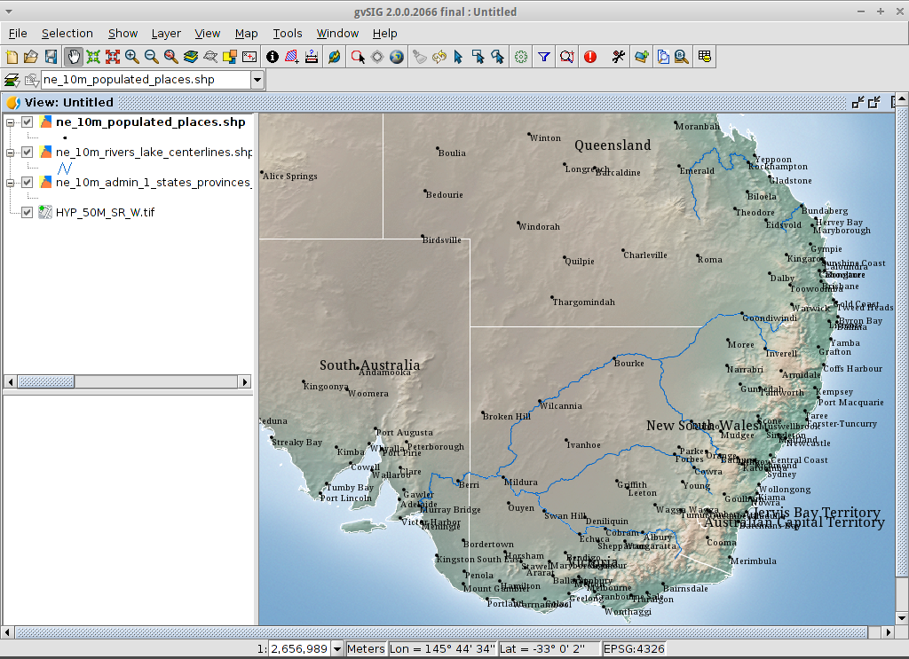

The result
Now we can easily know where the view is located in the world.
../../_images/gvsig_qs_018_6.png

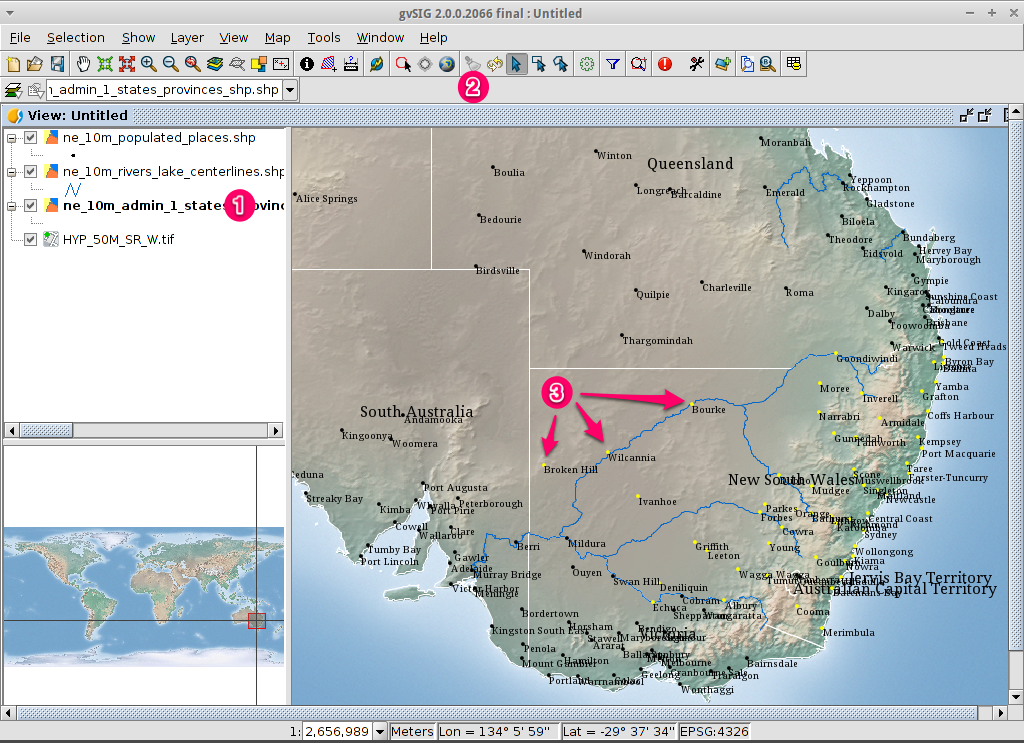

Selecting the region

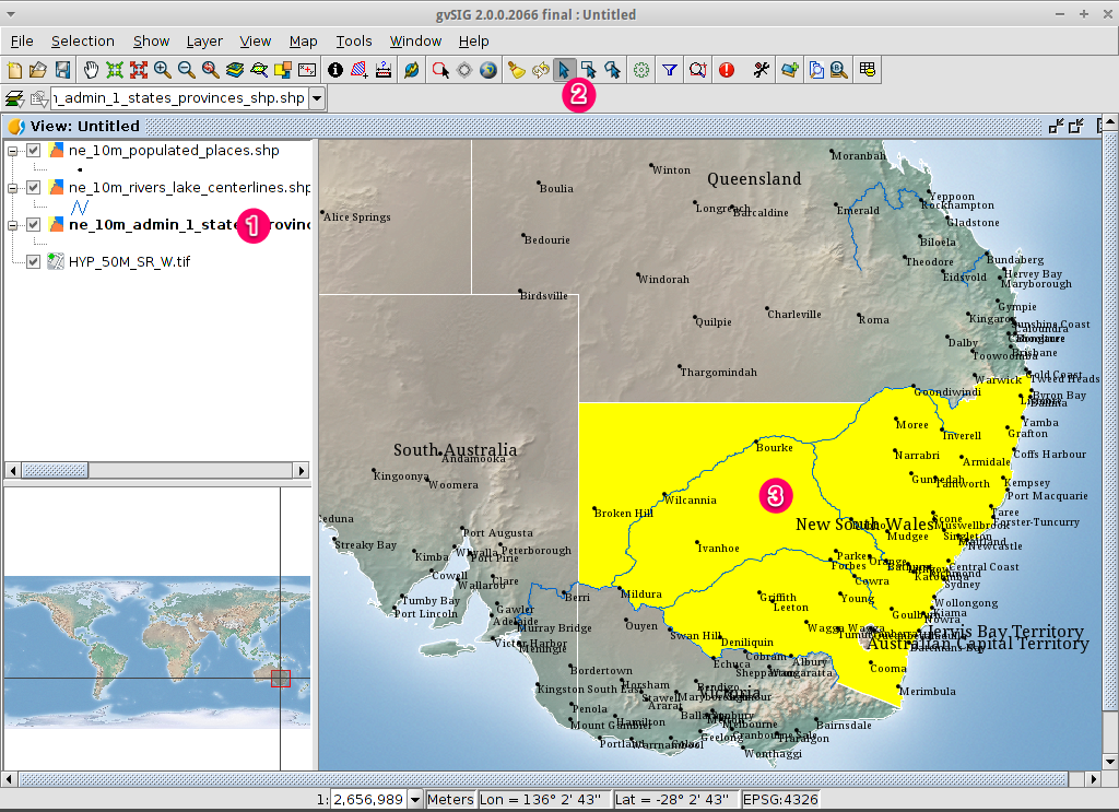

  1. Select the ne_10m_admin_1_states_provinces.shp layer using the left-mouse-button.
  2. Select the Select by point icon in the main toolbar.
  3. Click the polygon representing the State of New South Wales. The polygon will go yellow or some other colour depending on your user preferences.
../../_images/gvsig_qs_019_6.png

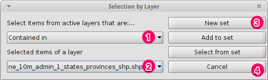

Opening the Selection by layer tool
  1. Select the ne_10m_populated_places.shp layer using the left-mouse-button.
  2. Select Selection ‣ Select by layer to open the Selection by Layer dialog
../../_images/gvsig_qs_020_6.png
Selecting the towns contained within a region
  1. Change the first selection criteria using the dropdown boxes on the left-hand side of the Selection by Layer dialog as shown in the picture.
  2. Change the second selection criteria as shown in the picture.
  3. Click the New set button to select towns within the selected polygon.
  4. Select the Cancel button in the Selection by Layer dialog to return to the view.
../../_images/gvsig_qs_021_6.png

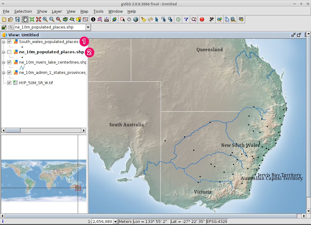

Unselect the polygon so you can see what has happened
  2. Select the ‘Clear selection’ icon in the main toolbar.
  3. You can now see that the only those towns within New South Wales are selected.
../../_images/gvsig_qs_022_6.png

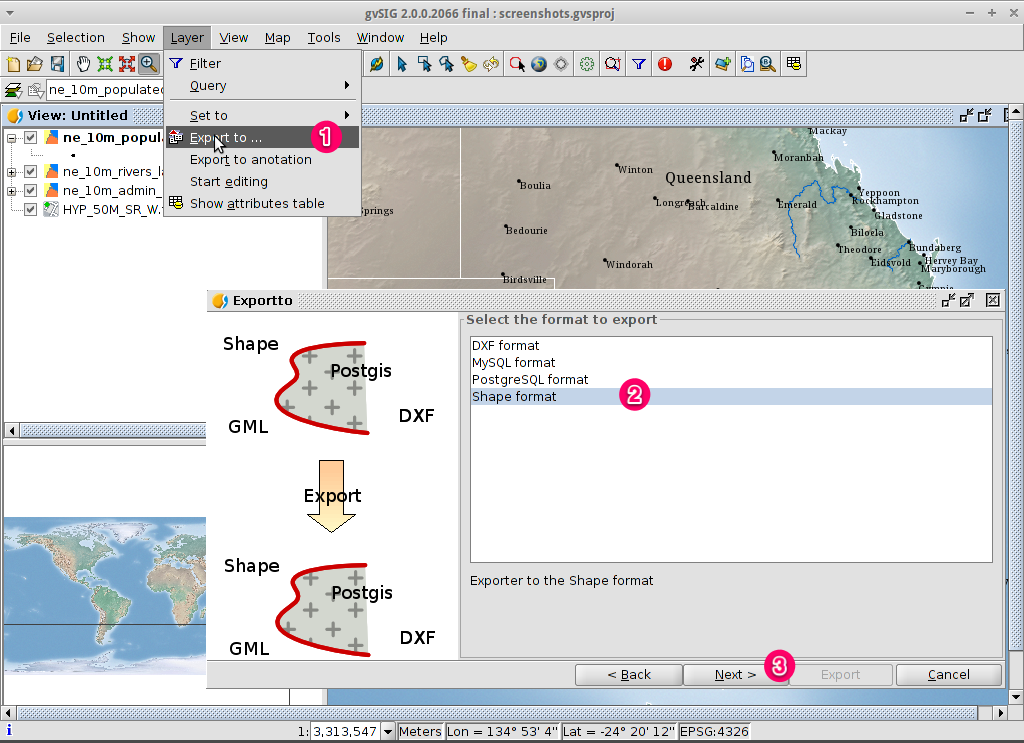

  2. Select Layer ‣ Export to... ‣ Shapefile to start the export.
  3. Select Shape Format.
  4. Click on Next.

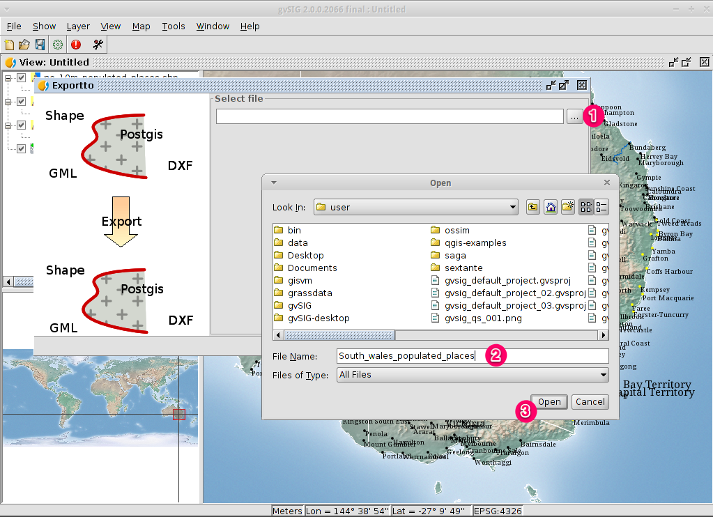

Selecting the output file name
  1. Choose a folder and type the file name.
  2. Click on Open and then on Next.
../../_images/gvsig_qs_024_6.png

The Result
  1. The new layer has been added to the view.
  2. In order to check that the export was ok set the original file as invisible. Only the towns of New South Wales should be shown.
../../_images/gvsig_qs_026_6.png

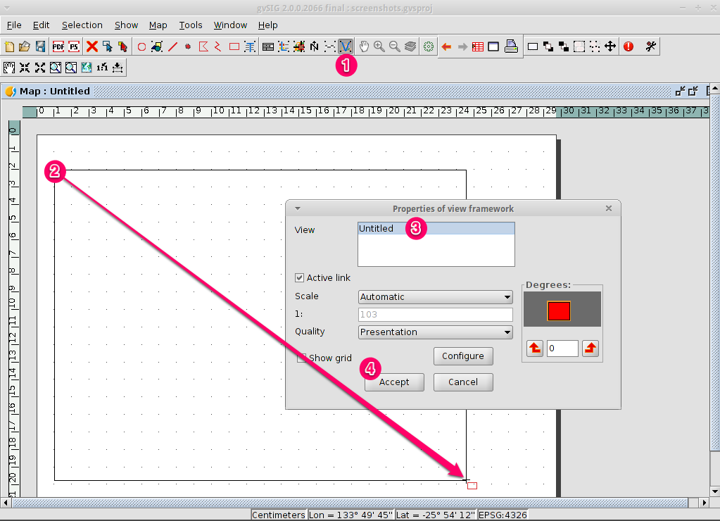

Insert a view inside the map
  1. Click on the Insert view icon in the main menu
  2. Create a bounding box representing the extent of the map on the page by clicking on the empty map while holding down the left-mouse-button and dragging out the box, only letting go once the the area to be used is complete. This opens the Properties of view framework dialog.
  3. Select the view created earlier.
  4. Select the Accept button to exit and return to your map.
../../_images/gvsig_qs_028_6.png

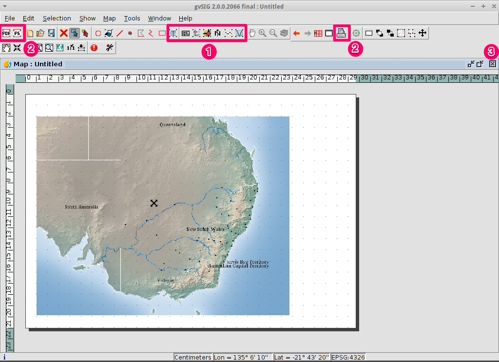

What else can you do to a map?
  1. Additional elements like a scale and north arrow can be added to the map using the icons in the main toolbar or with the submenus in the Map menu.
  2. The map can be printed or exported to PDF or Postscript for incorporation into other works.
  3. Select the Close window icon to return to the Project manager

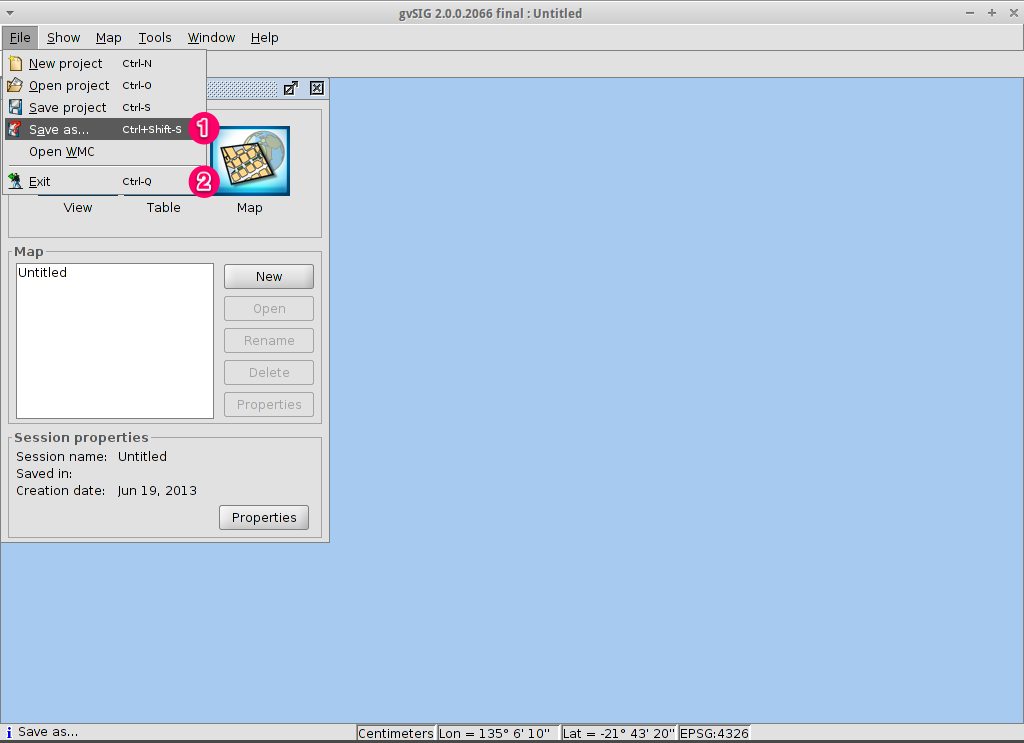

Saving your project or exiting gvSIG
  1. Projects can be saved for use later by using the File ‣ Save as... menu option, or
  2. Projects can be exited or closed by using the File ‣ Exit menu option.

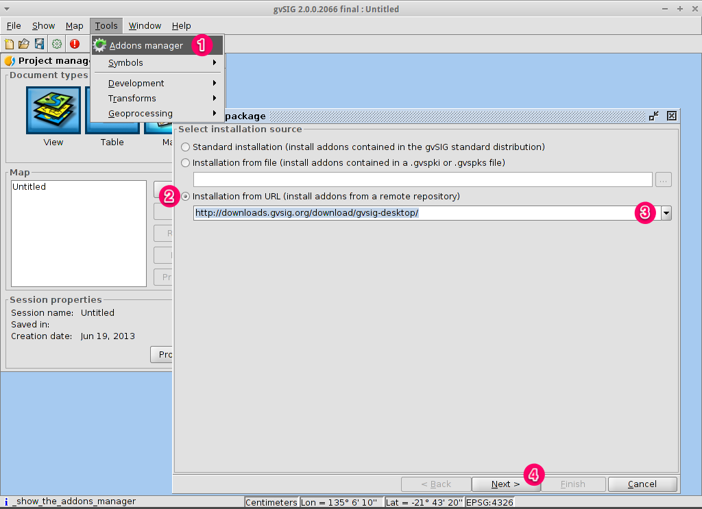

Opening the add-ons manager
  1. Select Tools ‣ Addons manager. After a while it will a appear the Install package window.
  2. Within the Install package window, select the option Installation from URL.
  3. Choose the repo URL shown in the picture.
  4. Click on the Next button.
../../_images/gvsig_qs_031_6.png

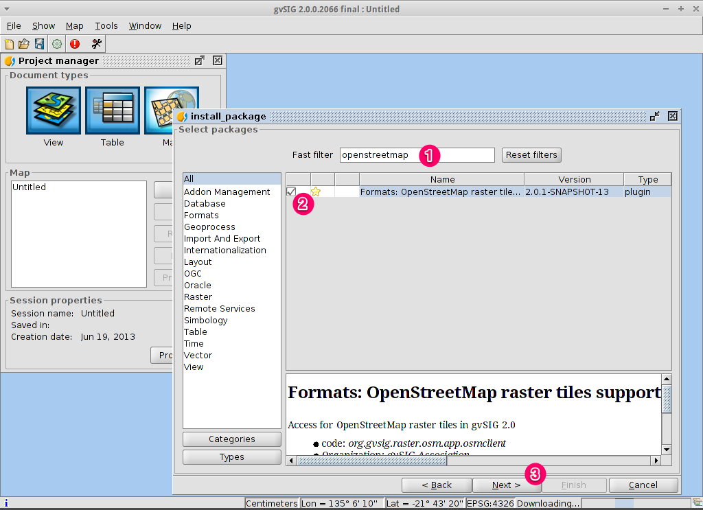

  1. Type ‘OpenStreetMap’ in the Fast filter text box.
  2. Check the add-on called Formats: OpenStreetMap raster tiles support.
  3. Click on Next.

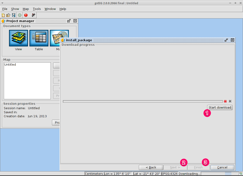

Finishing the installation
  1. Click on Start downloading.
  2. Then click on Next.
  3. Finally click on Finish.
../../_images/gvsig_qs_033_6.png

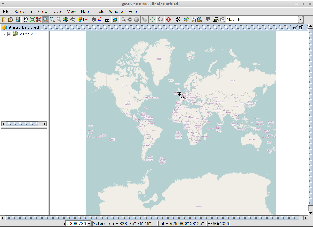

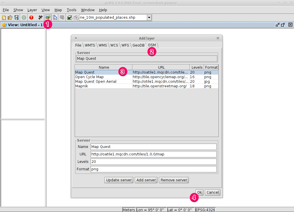

Trying the new add-on: adding a OpenStreetMap layer
As estated in the message we find after the installation of the add-on, a restart is needed.
  1. Coming back in gvSIG, within a new view, click on the Add layer… button.
  2. Choose the OSM tab.
  3. Select one of the available layers.
  4. Click on Ok.
../../_images/gvsig_qs_036_6.png

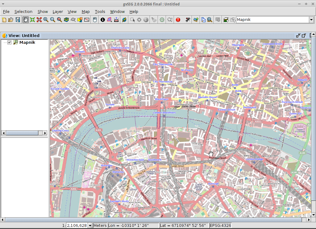

The result
A new layer has been added to the view. Just doing zoom over a region we could see the detailed Open Street Map data.
../../_images/gvsig_qs_037_6.png ../../_images/gvsig_qs_038_6.png

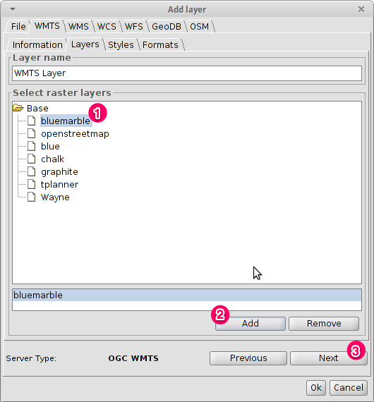

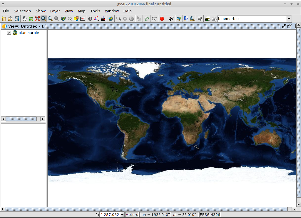

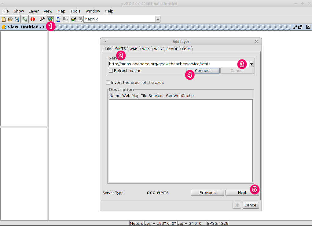

Adding a WMTS layer
WMTS is a evolution of WMS OGC standard based on tile management.
Selecting a server
  1. Within a view, click on the Add layer… button.
  2. Choose the WMTS tab.
  3. Choose the URL shown in the picture.
  4. Click on Connect.
  5. Click on Next.
../../_images/gvsig_qs_039_6.png
Selecting one of the available layers
  1. Select one of the available layers (e.g. bluemarble)
  2. Click on Add.
  3. Click on Next.
../../_images/gvsig_qs_040_6.png

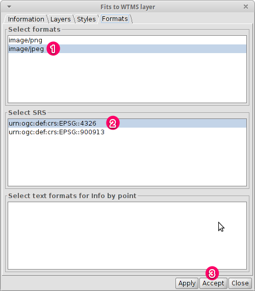

Selecting image format and reference system
  1. Select image/jpeg as image format.
  2. Select EPSG:4326 (notice that the view must have the same SRS. If not then cancel, change it and start again).
  3. Click on Accept.
../../_images/gvsig_qs_041_6.png
The result
../../_images/gvsig_qs_042_6.png
