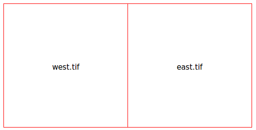

Raster tileindex with gdaltindex
You can build a shapefile as a raster tileindex. For every image a polygon is generated with the bounds of the extent of the polygon and the path to the file.
gdaltindex index_natural_earth.shp *st.tif
Have a look at your output shapefile with QGIS and ogrinfo (you will learn more about ogrinfo later in this tutorial)

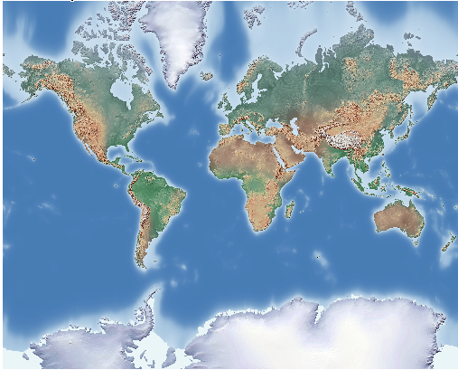

The gdalwarp command can be used to reproject images. Here we reproject the WGS84 geographic image to the Mercator projection:
gdalwarp -t_srs '+proj=merc +datum=WGS84' HYP_50M_SR_W_4326.tif mercator.tif
Use gdalinfo to verify the change and have a look at the image.

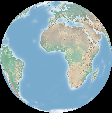

Here we reproject to the Ortho projection.
gdalwarp -t_srs '+proj=ortho +datum=WGS84' HYP_50M_SR_W_4326.tif ortho.tif
../../_images/gdal_ortho7.png
Note how the poles are clipped? This is because the edges at the pole can’t be reprojected gdalwarp does not read all the data. We can force gdalwarp to read a bunch of surplus data around chunks as one way to resolve this. Read more about this in the RasterTutorial http://trac.osgeo.org/gdal/wiki/UserDocs/RasterProcTutorial.
