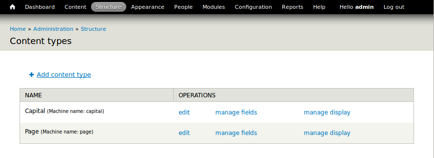

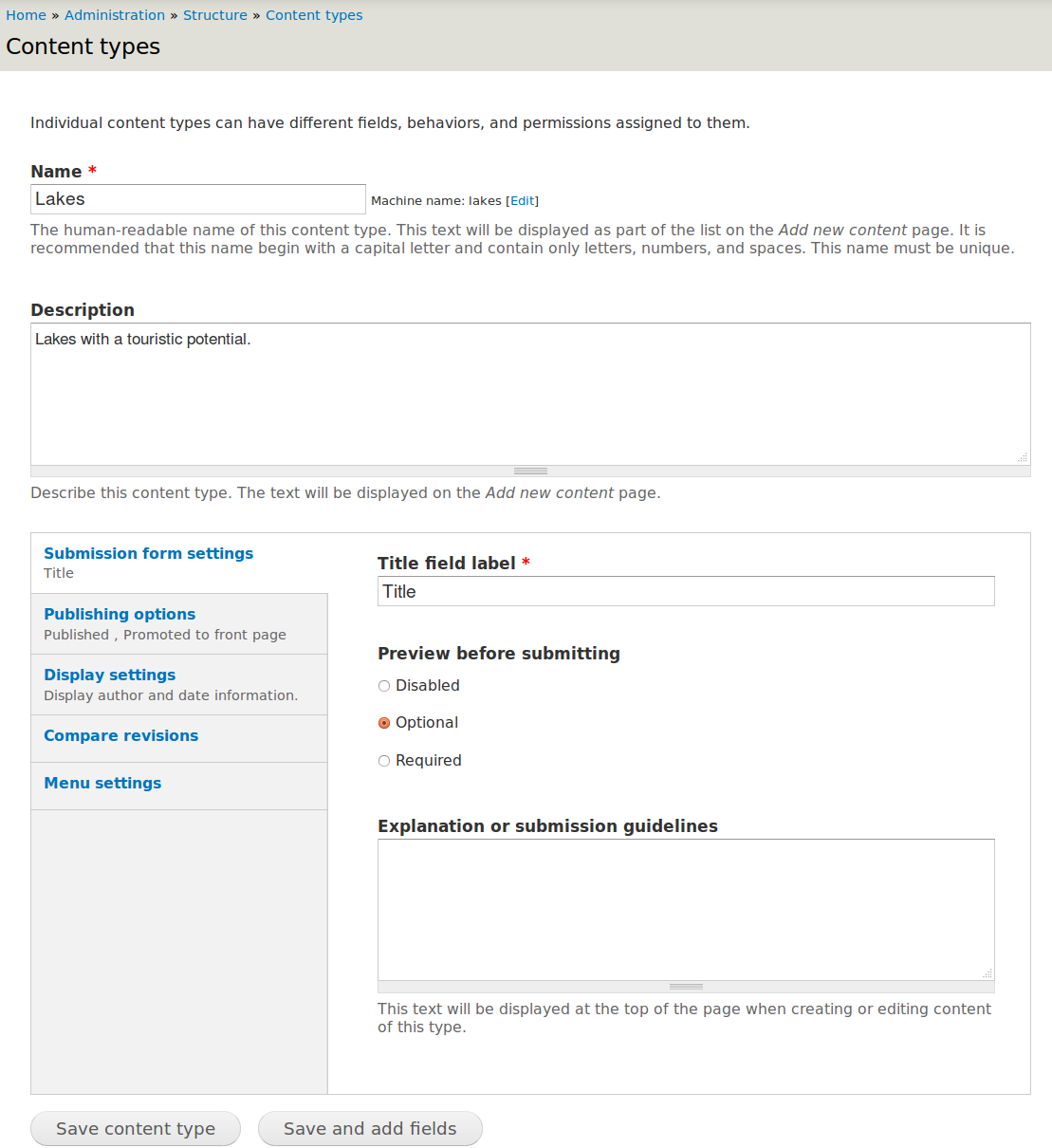

  • Choose Structure ‣ Content types on the menu bar and click on Add content type
../../_images/cartaro_addcontenttype6.png
  • Type a name for the new content type and describe it if you want.
../../_images/cartaro16.png
  • Finish by click on Save and add fields

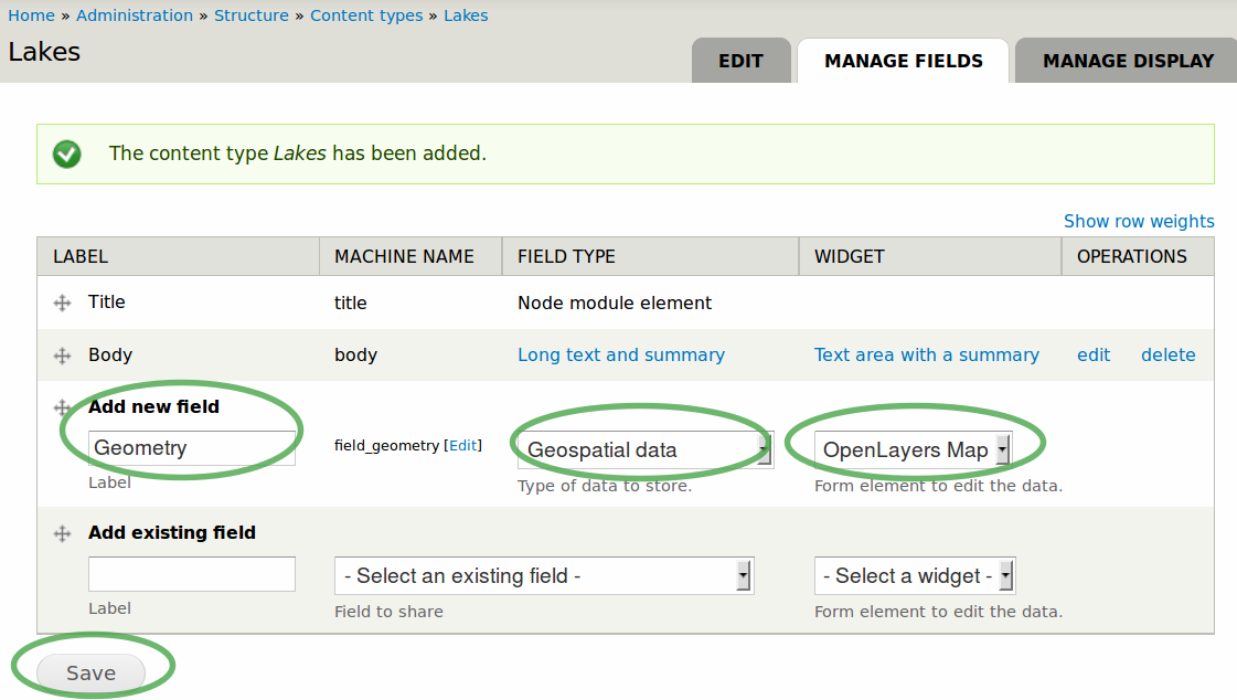

  • Add a new field for your content type by entering a descriptive name. We want to create a geospatial field with the name Geometry. Select Geospatial data as field type and OpenLayers Map as widget.
../../_images/cartaro26.png

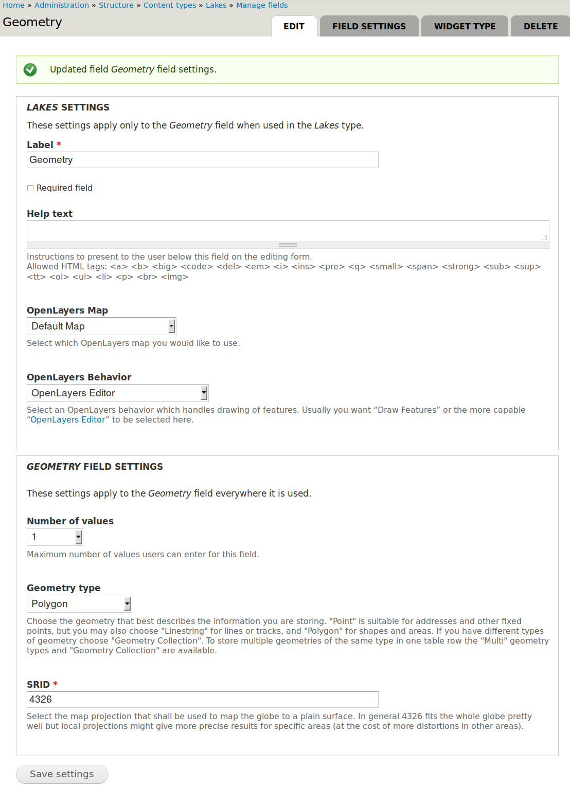

  • Choose your field settings in the new window: Select the geometry type that describes the kind of geospatial information you want to store. Choose Polygon to follow our example.
../../_images/cartaro36.png
Tip
Read the text below the Geometry type drop-down box to find the geometry type that fits your needs.
  • Finish by click on Save field settings
../../_images/cartaro46.png

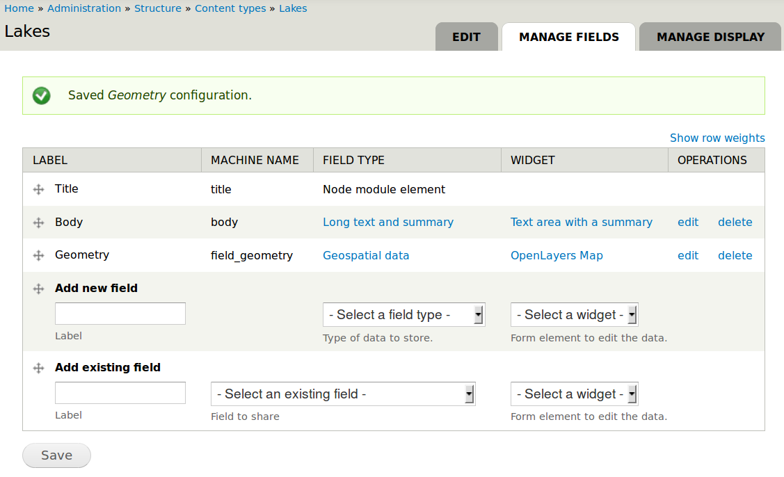

  • Press Save settings to finish the field creation
../../_images/cartaro56.png
  • Under the tab Manage fields you could create further non-geospatial fields. We don’t need to create a new one for our example.

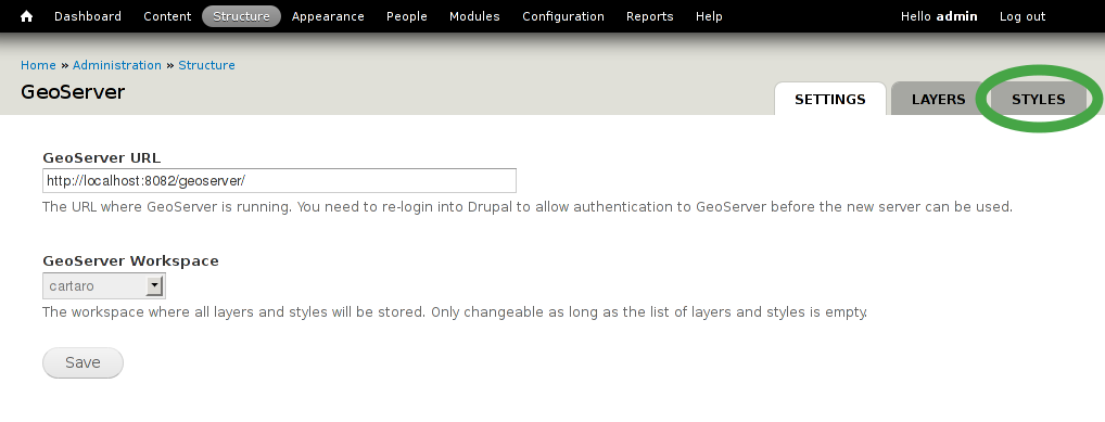

  • Choose Structure ‣ GeoServer from the menu bar to visit the GeoServer configuration page
../../_images/cartaro_geoserver_entry7.png

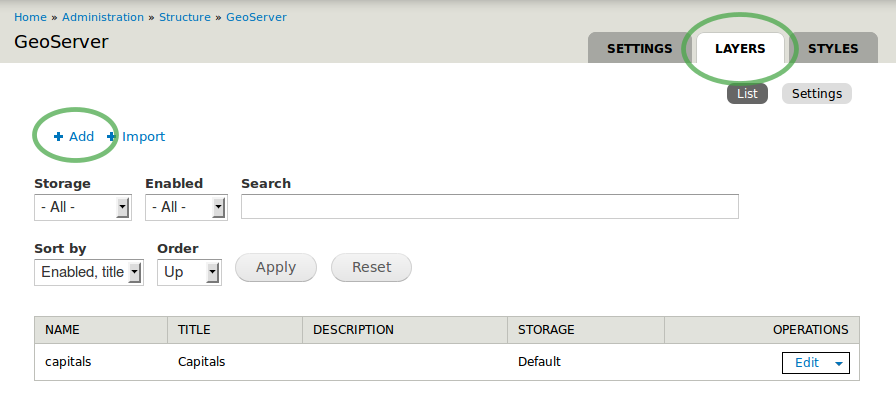

  • Choose Structure ‣ GeoServer from the menu bar to visit the GeoServer configuration page again

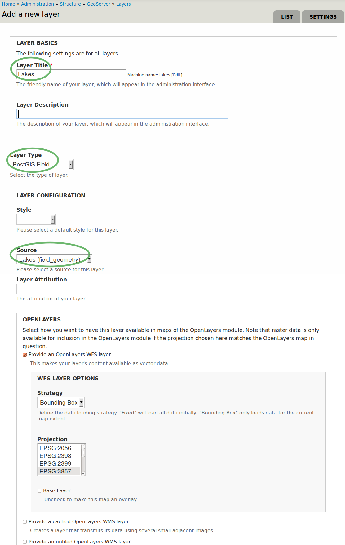

  • Select Layers and click Add to add a new layer
../../_images/cartaro_geoserver_addnewlayer6.png
  1. Type a suitable layer title (e.g. lakes).
  2. Select the layer type. We choose PostGIS Field for advanced geospatial operations and geodata storage.
  3. As source select your created content type which will be associated with your new layer.
  4. Make the checkmark Provide an OpenLayers WFS layer within the OpenLayers section.
  5. Finish configuration by click on Save
../../_images/cartaro76.png

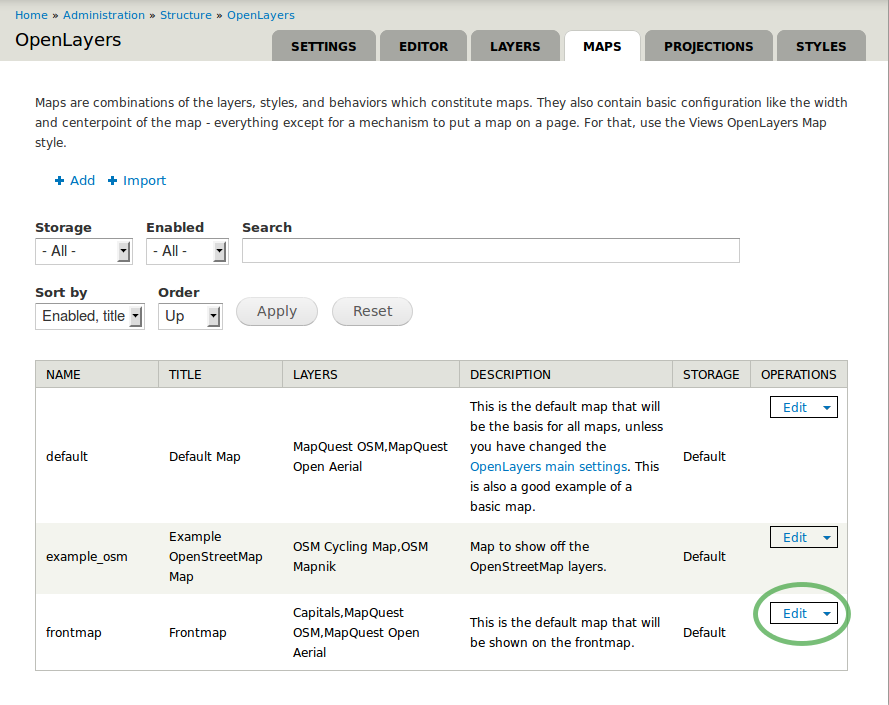

  • Go to Structure ‣ OpenLayers ‣ Maps to visit the OpenLayers maps configuration page
  • Look for frontmap - a pre-generated, default map and select Edit on the right side.
../../_images/cartaro_openl_maps_frontmapedit6.png

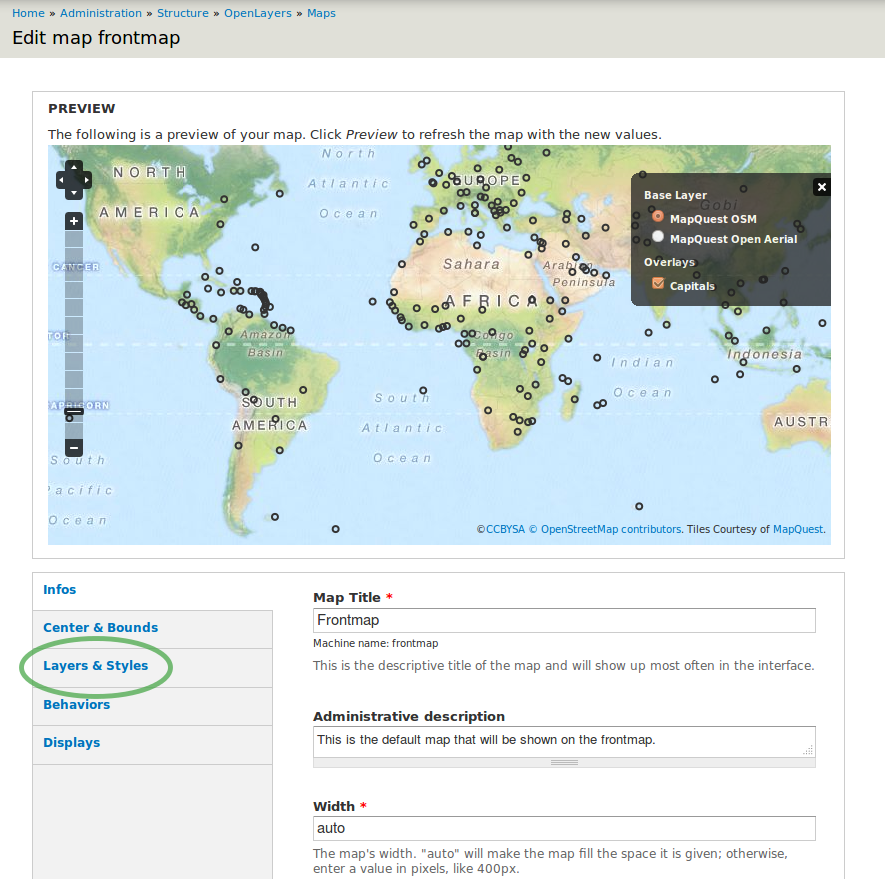

  • frontmap’s configuration page appears as shown on the screenshot below.
../../_images/cartaro_openlayers_frontmapediting6.png
  • Select Layers & Styles in the left sidebar to add our newly created layer to the frontmap.
  • Look for your created GeoServer layer (‘lakes’ in our example)
  • Make checkmarks for Enabled, Activated and In Switcher to activate your new layer lakes in your map

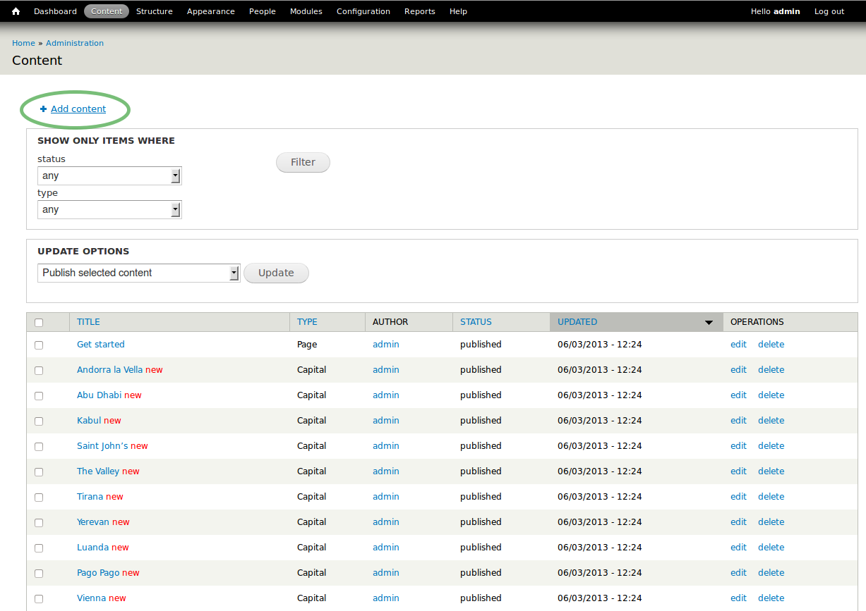

  • Choose Content from the menu bar to see all existing content elements within your Cartaro installation
../../_images/cartaro_contentlist6.png
  • Select Add content to add more content and choose your new content type in the appearing window (not shown). In the configuration page of your new content element (called node in Drupal language) make the following settings:

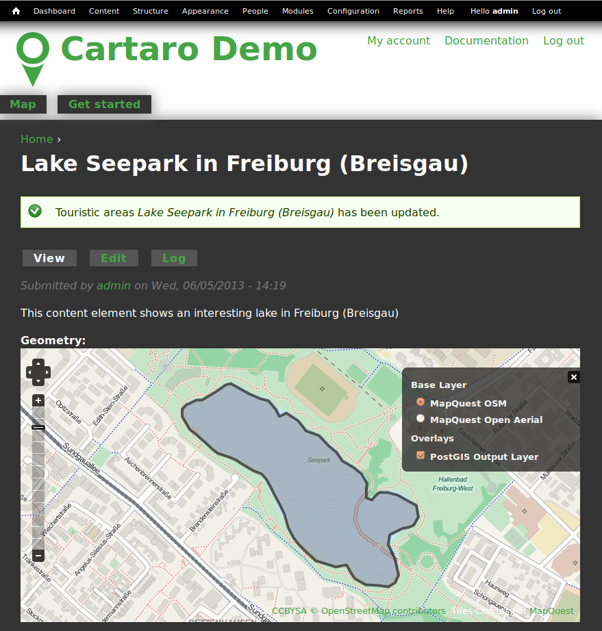

  • You should now see your new content element
../../_images/cartaro_addedcontent_lakefr6.png
  • To view your new content element on the front map, click on the house icon in the upper left corner
../../_images/cartaro_addedcontent_frontmap6.png
