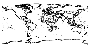

> plot(countries)
This gives us a simple map of the world:
../../_images/r_plot17.png

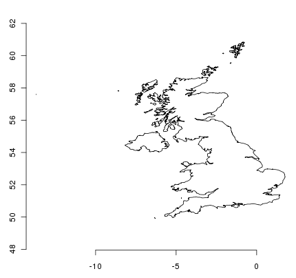

When an OGR dataset is read into R in this way we get back an object that behaves in many ways like a data frame. We can use the admin field to subset the world data and just get the UK:
> uk = countries[countries$admin == "United Kingdom",]
> plot(uk); axis(1); axis(2)
../../_images/r_plot27.png
This looks a bit squashed to anyone who lives here, since we are more familiar with a coordinate system centred at our latitude. Currently the object doesn’t have a coordinate system assigned to it - we can check this with some more functions:

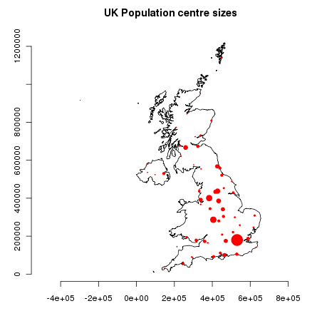

We add these points to the base map, scaling their size by scaled square root of the population (because that makes a symbol with area proportional to population), set the colour to red and the plotting character to a solid blob:
> points(ukpop, cex=sqrt(ukpop$POP_MAX/1000000), col="red", pch=19)
> title("UK Population centre sizes")
and our final image appears:
../../_images/r_plot37.png
