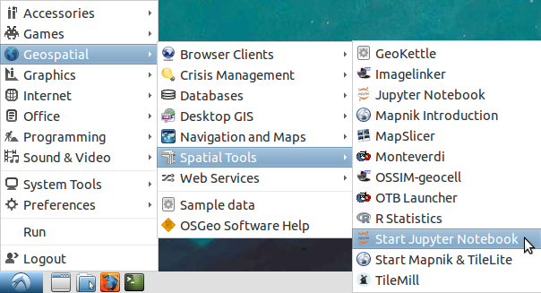

Start the jupyter server

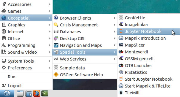

From the application launch menu in the lower left corner.
  • Choose Geospatial -> Spatial Tools -> Start Jupyter Notebook
../../_images/jupyter1-15.png
A terminal window will open and a startup log will begin to scroll.

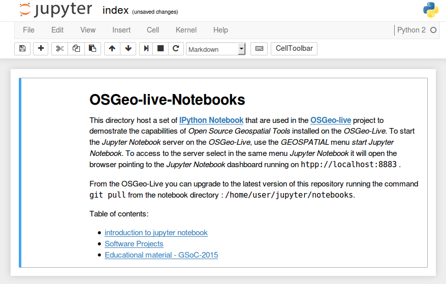

  • Choose Geospatial -> Spatial Tools -> Jupyter Notebook
../../_images/jupyter1-25.png
A web browser is launched showing the notebook dashboard.
../../_images/jupyter1-35.png

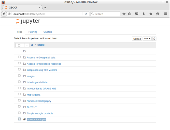

From the notebook dashboard you can navigate the directory tree, start new notebooks, create files and directories, as well as rename, delete and upload files.
Open and execute an existing notebook
Let’s open an existing notebook. From the main page click on the directory GSOC.
../../_images/jupyter25.png

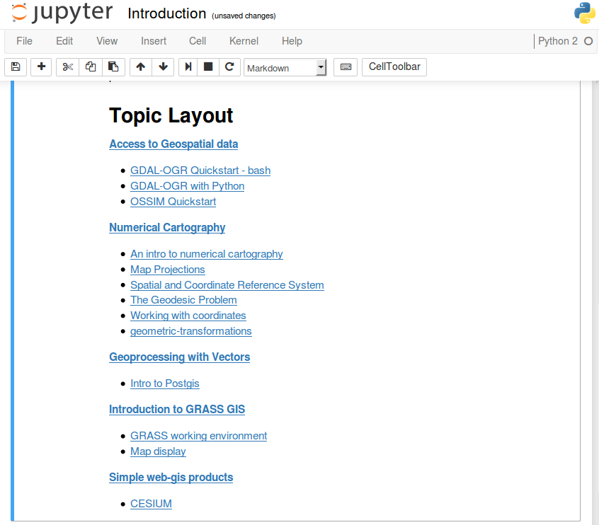

Choose the Introduction notebook.
../../_images/jupyter35.png
This is a simple notebook, which contains text and links, like a HTML web page.

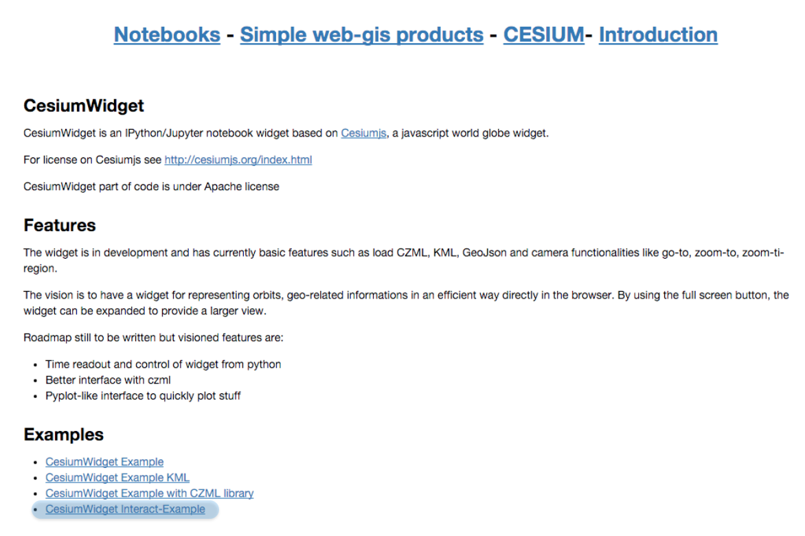

Then under “Simple-web-gis-products” select “CESIUM”.
../../_images/jupyter45.png

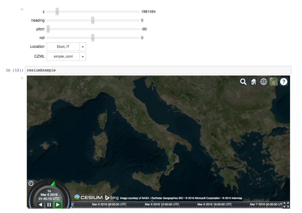

Here there are a series of example using the cesium javascript library. Let’s click on “CesiumWidget Interact-Example”, which uses the widget extension, some python libraries and cesium-js.
From the toolbar on top of the notebook chose: cell->run all. If everything worked as planned you should be able to see the results at the bottom of the page.
../../_images/jupyter55.png
