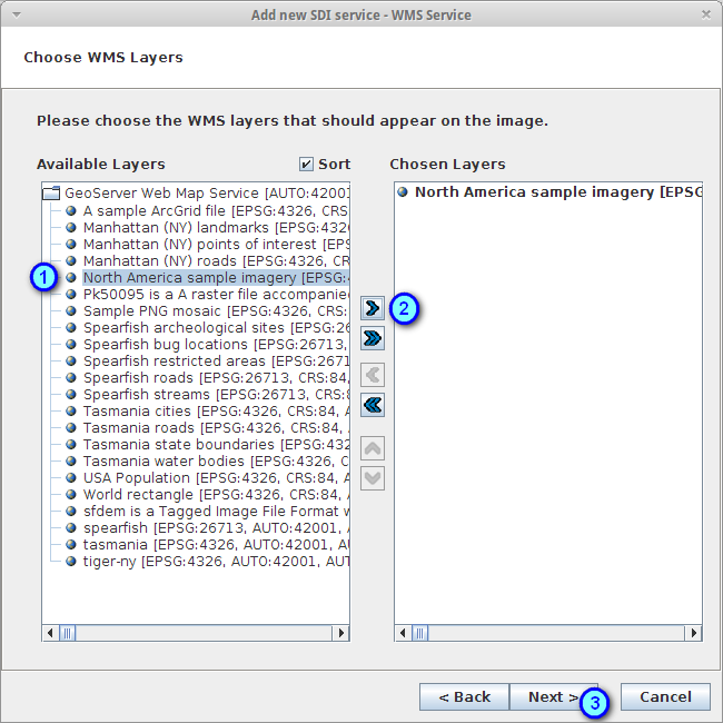

  6. Select the layer North America Sample Imagery (1) and press the > button (2) to move it to the right list. Press Next button. (3)
    ../../_images/kosmo_wms_31.png

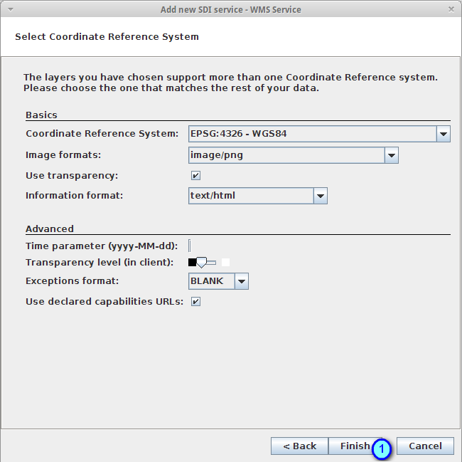

  7. Leave the default options loaded and press the Finish button (1) to start the layer loading
    ../../_images/kosmo_wms_41.png

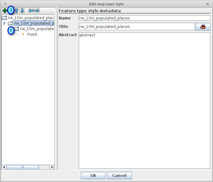

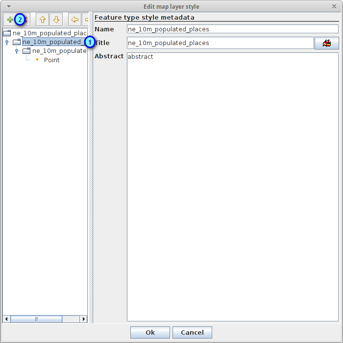

  3. Select the feature type style ne_10m_populated_places (1) and press the + button (2) to add a new rule to it
    ../../_images/kosmo_advanced_style_feature_type1.png

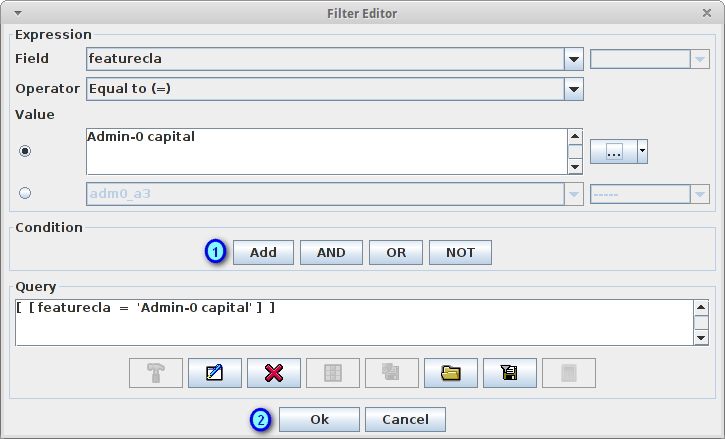

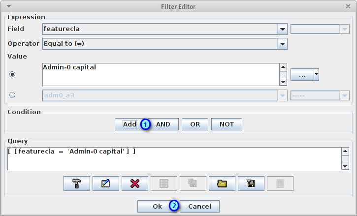

  6. Select featurecla as Field (1), Equal to (=) as Operator (2) and press the ... button (3) to select an attribute value
    ../../_images/kosmo_advanced_style_filter1.png
  7. Select the Admin-0 capital value (1) and press the Ok button (2)
    ../../_images/kosmo_advanced_style_attr_value1.png
  8. Press the Add button (1) to add the condition to the filter and the Ok button (2) to set the filter to the rule
    ../../_images/kosmo_advanced_style_filter_21.png

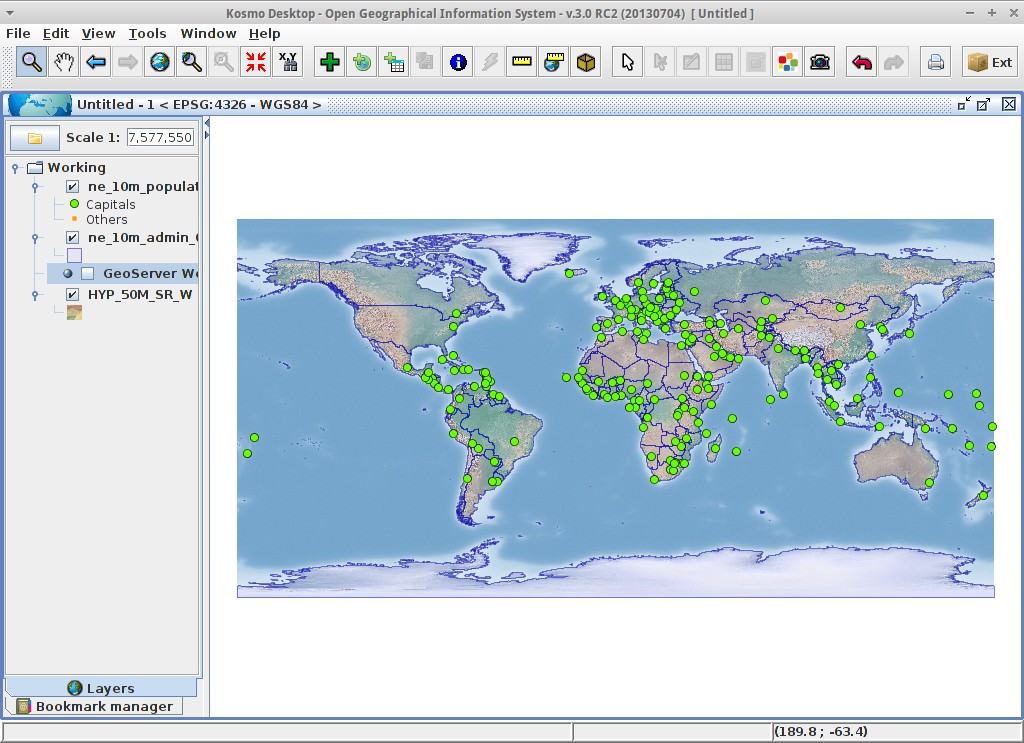

  11. Press the Ok button to apply the changes

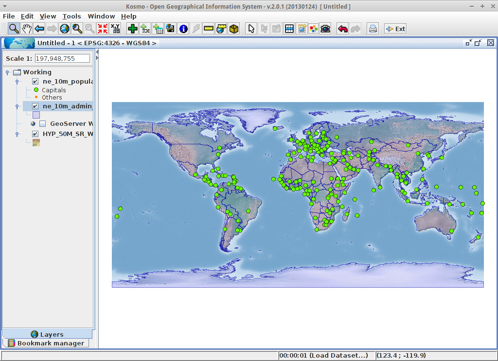

  12. The layer will change its style to reflect the changes:
    ../../_images/kosmo_styled_layer_by_filter1.jpg

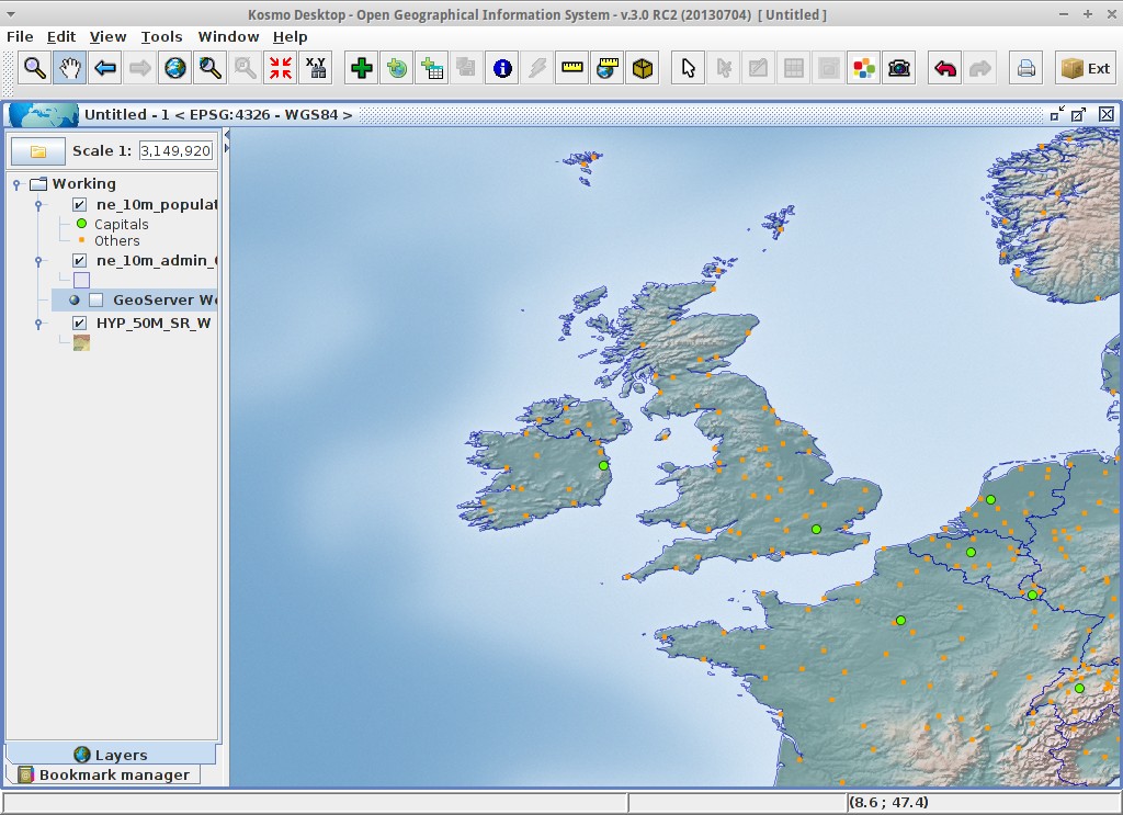

  13. If you make enough zoom in to reach the given scale, both rules would be rendered:
    ../../_images/kosmo_styled_layer_by_filter_21.jpg
Note
When the map is at full layer scale only capitals are shown. If you zoom in close enough, all the populated places would be shown
