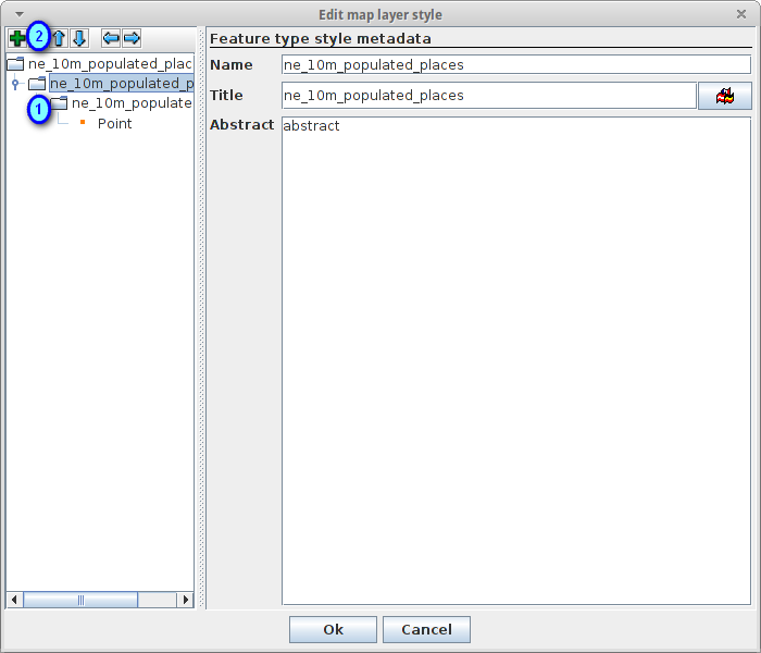

  1. Select the layer ne_10m_populated_places in the layer tree
  2. Right click on it and select the option Simbology > Advanced Style Editor...
  3. Select the feature type style ne_10m_populated_places (1) and press the + button (2) to add a new rule to it
    ../../_images/kosmo_advanced_style_feature_type2.png

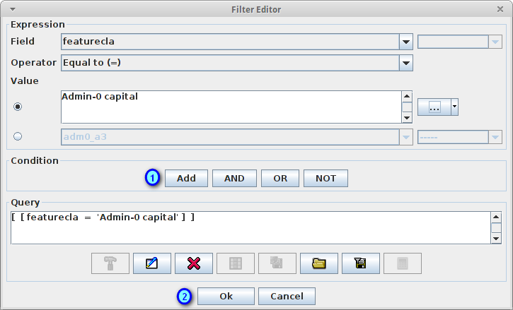

  6. Select featurecla as Field (1), Equal to (=) as Operator (2) and press the ... button (3) to select an attribute value
    ../../_images/kosmo_advanced_style_filter2.png
  7. Select the Admin-0 capital value (1) and press the Ok button (2)
    ../../_images/kosmo_advanced_style_attr_value2.png
  8. Press the Add button (1) to add the condition to the filter and the Ok button (2) to set the filter to the rule
    ../../_images/kosmo_advanced_style_filter_22.png

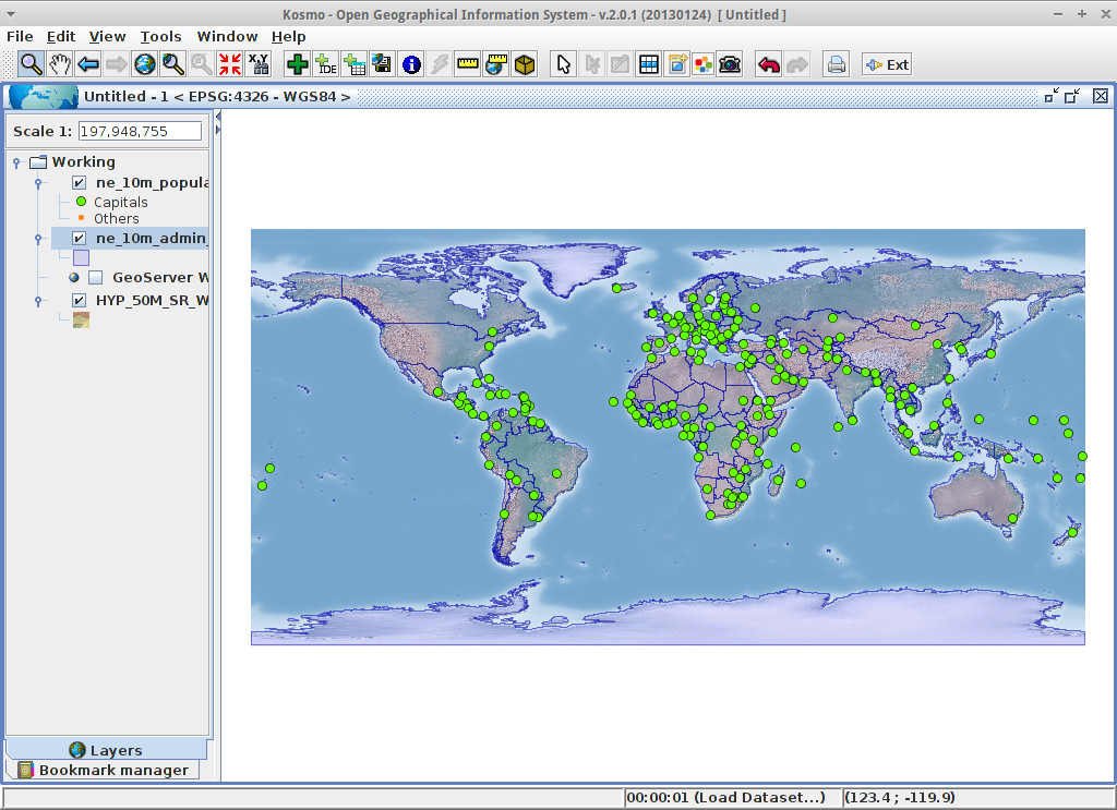

  12. The layer will change its style to reflect the changes:
    ../../_images/kosmo_styled_layer_by_filter2.jpg
Note
When the map is at full layer scale only capitals are shown. If you zoom in close enough, all the populated places would be shown
