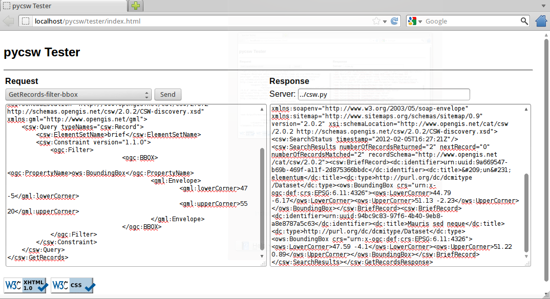

Also, the user can search for data records, performing a spatial bounding box query, by selecting “GetRecords-filter-bbox” and editing the coordinates in the XML request:
../../_images/pycsw_tester_getrecords_bbox_filter1.png
