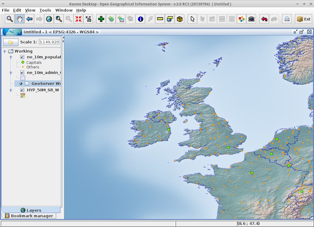

  11. You can see that the layer drawing order is from bottom to top in the layer tree: modify the layer order by dragging them in order to show them properly
    ../../_images/kosmo_load_file_example11.jpg

  8. In the layer tree, press the visibility checkbox to make the layer visible
  9. Select the layer in the layer tree and press the Zoom To Layer button to center the map in the WMS layer view
  10. Reorder the layer tree by dragging the new layer and put it over the HYP_50M_SR_W raster layer
    ../../_images/kosmo_load_wms_results11.jpg

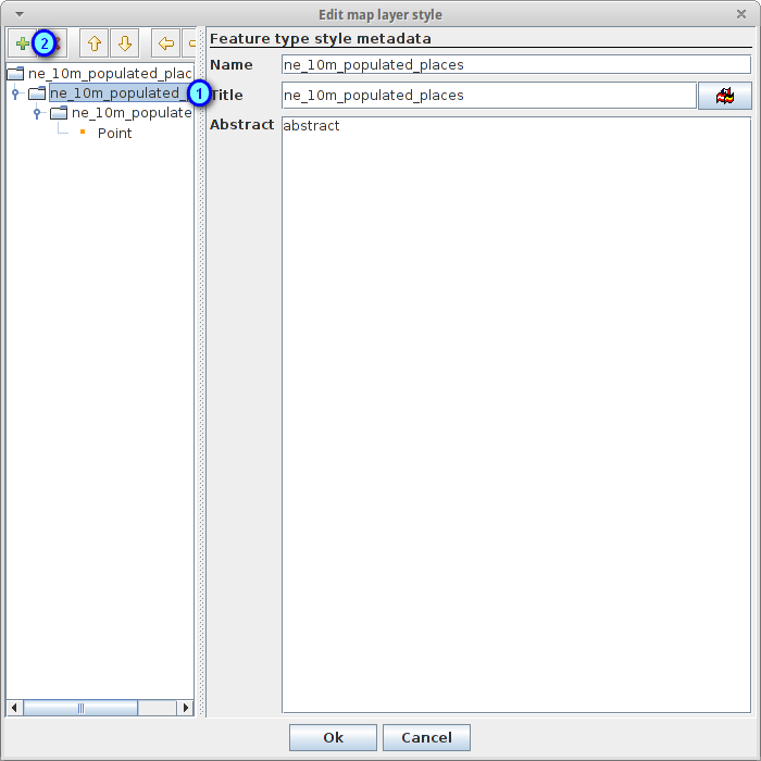

  3. Select the feature type style ne_10m_populated_places (1) and press the + button (2) to add a new rule to it
    ../../_images/kosmo_advanced_style_feature_type9.png

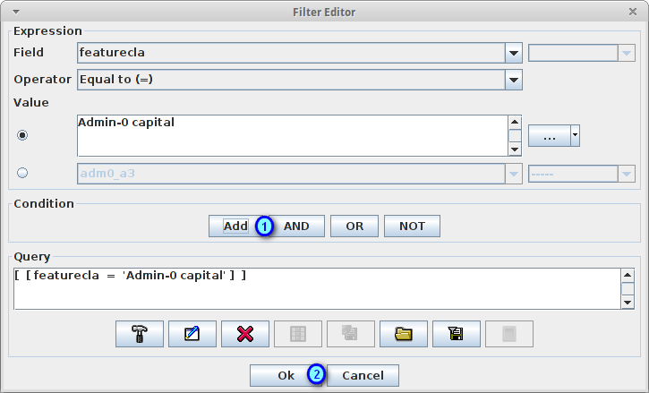

  6. Select featurecla as Field (1), Equal to (=) as Operator (2) and press the ... button (3) to select an attribute value
    ../../_images/kosmo_advanced_style_filter9.png
  7. Select the Admin-0 capital value (1) and press the Ok button (2)
    ../../_images/kosmo_advanced_style_attr_value9.png
  8. Press the Add button (1) to add the condition to the filter and the Ok button (2) to set the filter to the rule

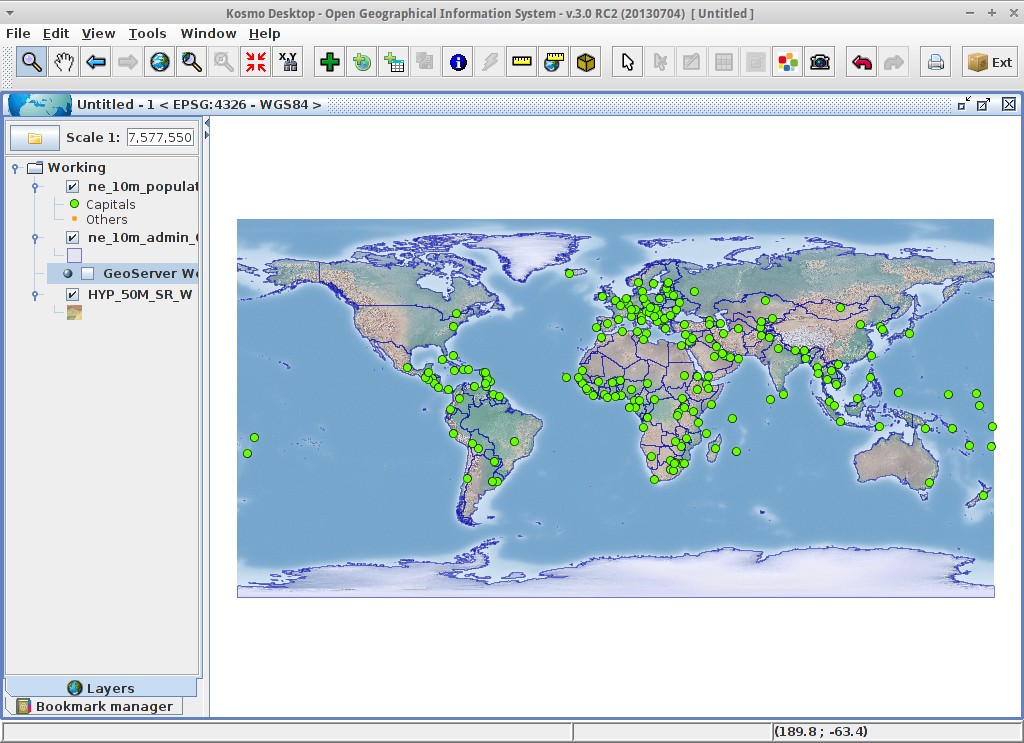

  12. The layer will change its style to reflect the changes:
    ../../_images/kosmo_styled_layer_by_filter9.jpg
