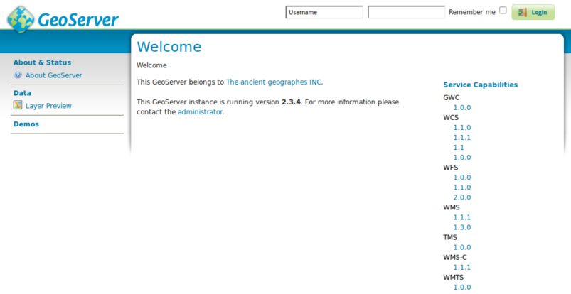

First Views

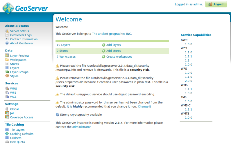

When you first open the GeoServer page you will see the screen above, first you need to log in using the username admin and password geoserver. You will now see the admin page.
../../_images/geoserver-welcome5.png

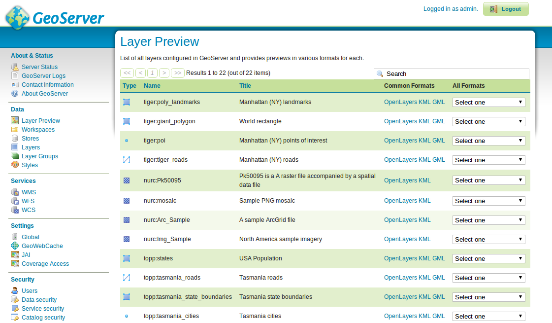

Select the Layer Preview link at the top of the Data section in the left hand menu to see a preview of the layers that are loaded on the server.
../../_images/geoserver-layerpreview5.png

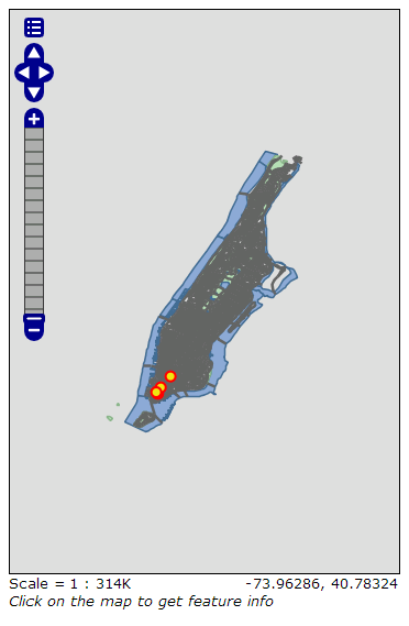

Scroll to the bottom of the page and click on the OpenLayers link in the tiger-ny row, this will open a new window with a preview of some of the sample data.
../../_images/geoserver-preview5.png
You can zoom in to the map in three ways:
  • by clicking on the zoom bar on the left, the higher you click on it the more zoomed in you will see.
  • by using the mouse scroll wheel (if you have one), scrolling up will zoom in and down will zoom out.
  • by dragging a box on the map while holding down the shift key - this will zoom in to the box selected (or as near as will fit in the screen).
Experiment with this view and look at some of the other previews. Once you are comfortable viewing existing data you can move on to adding some new data.

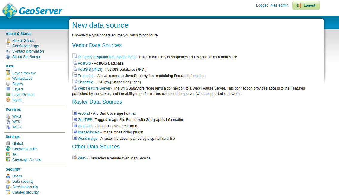

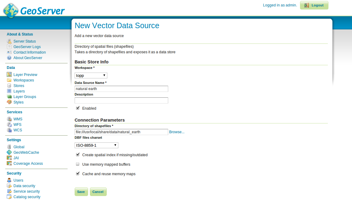

We need to create a Store for our data. From the GeoServer admin page go to Stores and then click on Add new Store. You will see this page:
The New Store page
Select the Directory of spatial files, you will see the following:
Filling in the New Store page
Type in a name for the Data Store - I used Natural Earth and fill in the URL to the data set - in this case /usr/local/share/data/natural_earth2/. You can use the browse button to find the directory if your data is somewhere else. Press save.

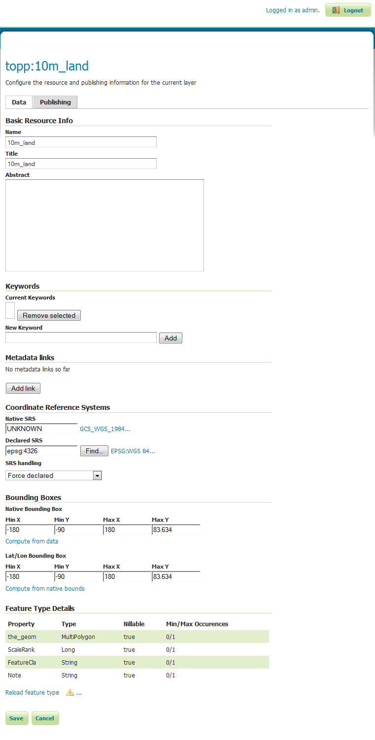

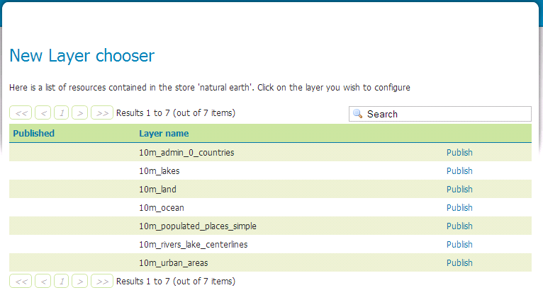

Press publish next to one of the layers to finish up adding the data. This will take you to the Layers page:
The layer publishing page
As you scroll down the page you will see that GeoServer has filled in many of the fields for you. When you reach Coordinate Reference System you will notice that under Native SRS that it says UNKNOWN you will need to fill in the next box (declared SRS) to make sure GeoServer knows where the data is. For the time being trust me and type epsg:4326 in the box, if you don’t trust me then go to http://prj2epsg.org/search and paste in the string you see if you click on the link next to “UNKNOWN”. Then click on Compute from data and Compute from native bounds to fill in the Bounding Boxes. Finally hit save and you have published your first layer.

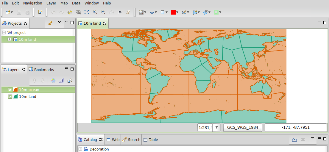

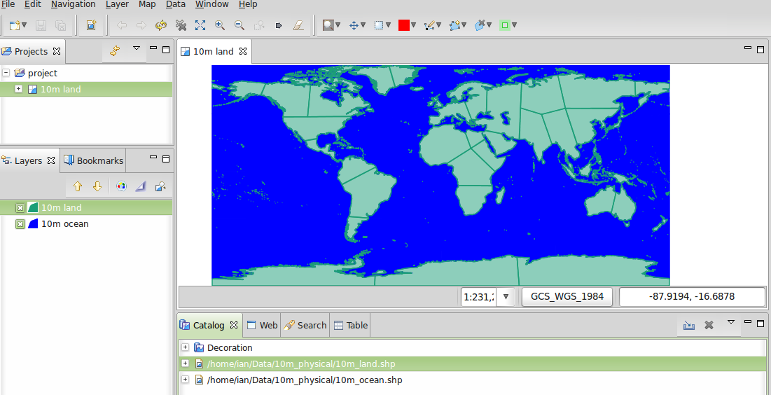

Once I opened uDig up and added the shapefiles (using the add data button in the top left hand corner). I dragged the ne_10m_land and ne_10m_ocean tables into the map window. uDig automatically applies a style (so you can see the data).
Default Styling in uDig
Now obviously an orange ocean will not work (even if I could live with the green land). So in the Layer list select the style button (it looks like an artist’s palette).
The Layer list window

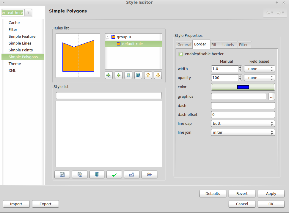

This will open the Style Pane - in the simple window I can easily select a nice blue for the oceans by clicking on the colored box on the fill tab and choosing from the color picker it produces. I also increased the opacity of the fill to 100% to make the color look better. I picked the same blue for the border color so it would match.
The Style Pane
Once I was done I clicked OK and uDig showed me the changes.
Blue Oceans

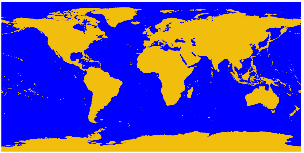

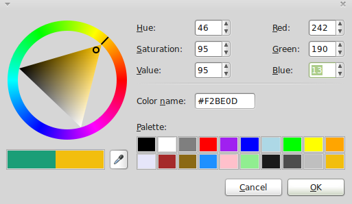

Finally I prefer a more understated land color than green so I repeated the steps above to change the color of the land layer. None of the default colors seemed right to me so I went into the define custom colors section to create one I liked.
Defining a nicer land color
This gives me a nice looking basic world map
A basic word map

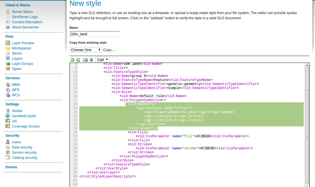

Now we need to transfer these styles to GeoServer - on the style window there is an export button which allows me to save the SLD file that defines my style. Once I’ve saved the two styles I can go to the GeoServer admin page again and select Styles (at the bottom of the Data section). Then I select the Add New Style link, at the bottom of that page is a file upload box and a browse button. Clicking this allows me to hunt around on my hard drive to find the files I just saved. Once I’ve found one I want, I click the upload link (next to the browse button) and a copy of my file appears in the editor. If you click on the validate button the highlighted lines will give you an error but you can safely ignore the error (or delete those lines as they don’t do anything). When you are ready press the Submit at the bottom of the page.
