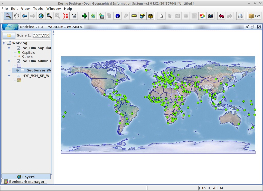

The layer will change its style to reflect the changes:

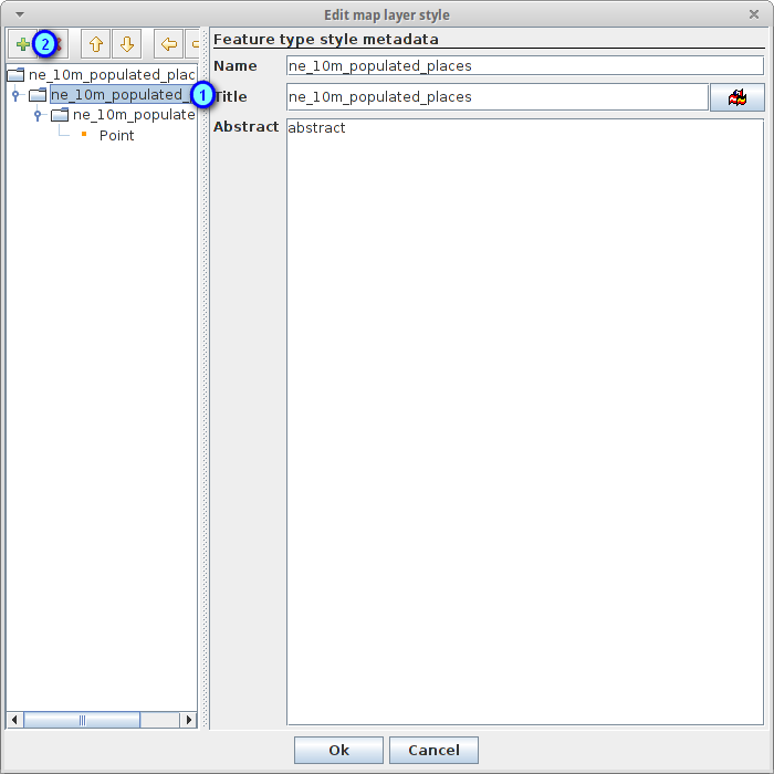

Select the feature type style ne_10m_populated_places (1) and press the + button (2) to add a new rule to it
Select Point symbolizer as symbolizer type (1) and press the Ok button (2)

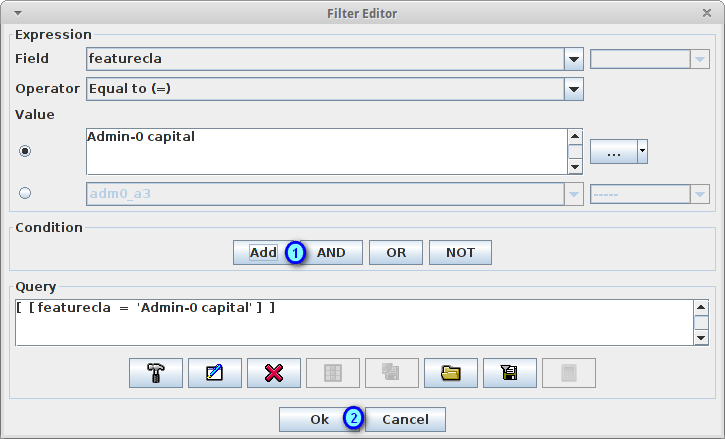

Select featurecla as Field (1), Equal to (=) as Operator (2) and press the ... button (3) to select an attribute value
Select the Admin-0 capital value (1) and press the Ok button (2)
Press the Add button (1) to add the condition to the filter and the Ok button (2) to set the filter to the rule

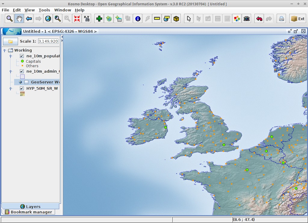

If you make enough zoom in to reach the given scale, both rules would be rendered:
Note
When the map is at full layer scale only capitals are shown. If you zoom in close enough, all the populated places would be shown
