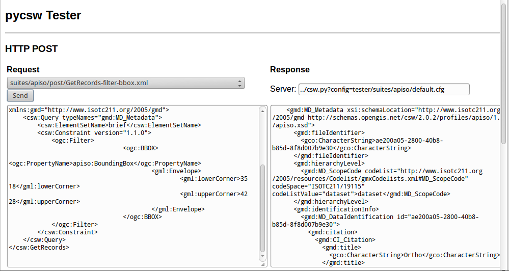

  3. You can search for data records, performing a spatial bounding box query, by selecting “GetRecords-filter-bbox” and editing the coordinates in the XML request.
    ../../_images/pycsw_tester_getrecords_bbox_filter.png
